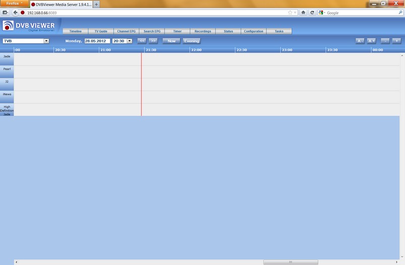

Mr. Man-wai Chang Posted June 4, 2012 Posted June 4, 2012 I like to add my vote to this bug. Here is a screenshot of the error in Recording Service. It seems that the bug happened right after a recording of TVB channel was started. Not too sure.

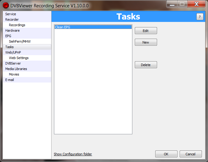

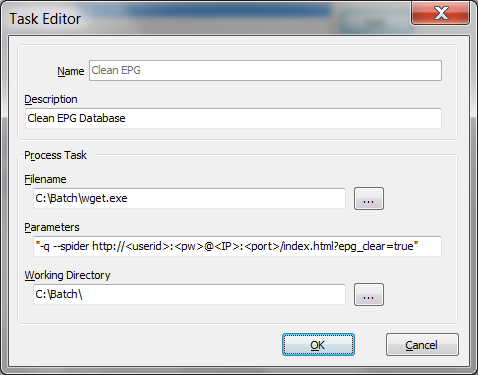

EDC Posted July 23, 2012 Posted July 23, 2012 I use "Recording Services API" and "wget" to solve the problem with TVB epg. - Uncheck Automatic EPG Update every 12 hours if PC is active. - Add an external task in Recording Services, e.g. Clean EPG, - Point to wget.exe in your PC and set parameter "-q --spider http://<login>:<password>@<ip>:<port>/index.html?epg_clear=true" - Schedule Clean EPG task and Scan EPG task in midnight.
EDC Posted July 24, 2012 Posted July 24, 2012 (edited) Correct parameter and screen shot for external task. - Point to wget.exe in your PC and set parameter "--quiet --spider http://<login>:<password>@<ip>:<port>/index.html?epg_clear=true" (without double quote) Edited July 24, 2012 by EDC
