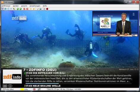

Tjod Posted June 27, 2012 Posted June 27, 2012 Hi Tjod, yes it is really handy, especially in football tournaments like we had a couple of weeks ago when there were 2 games on different channels.OK picture in picture in DVBViewer Pro works only on one monitor. The only reason I can think of, to run two DVBViewer instances is to have two channels on separate monitors. But in this case I would use the Recording Service for recording and manage the hardware. Other usefullness is that you can record on the three seperate channels (like the Virgin+ Tivo Box) to watch later.You can do this with one DVBViewer instance as well. If you have 3 tuner in one instance you can record all unencrypted channels on 3 frequents at the seam time (encrypted channels one per tuner). Quote
fxv1 Posted June 27, 2012 Posted June 27, 2012 OK that is good too, I know you can setup the setting for PiP in the DirectX section but how do you get PiP to work? Could not find anything in WiKi (I presume this is tuner dependent) and visited all the drop down menus. Frank Quote
Tjod Posted June 27, 2012 Posted June 27, 2012 OSD-Menu [Esc] > Picture in Picture >> [pip and main have the same channel] >> change the main playback channel. OSD-read [F5] > swap sound OSD-blue [F8] > Help for more keyboard shout cuts for pip. Via mouse: double click on pip > swap main and pip channel drake and drop the pip position change the size via drake and drop at the down right corner of the pip Quote
fxv1 Posted June 28, 2012 Posted June 28, 2012 OSD-Menu [Esc] > Picture in Picture >> [pip and main have the same channel] >> change the main playback channel. OSD-read [F5] > swap sound OSD-blue [F8] > Help for more keyboard shout cuts for pip. Via mouse: double click on pip > swap main and pip channel drake and drop the pip position change the size via drake and drop at the down right corner of the pip Hi Tjod, tried the PiP yesterday and it did work. By the way the option is via the Preview (there is no Pip I could find). I found it to be awkward to keep track off and the PiP disappeared when using the menu system so you have to select it again. I could not get the mouse click to do anything with the "Preview" function. I prefer to have 2 controllable windows that you can re-size as needed. You can also control the sound. Thanks for the tip anyway. Frank Quote
