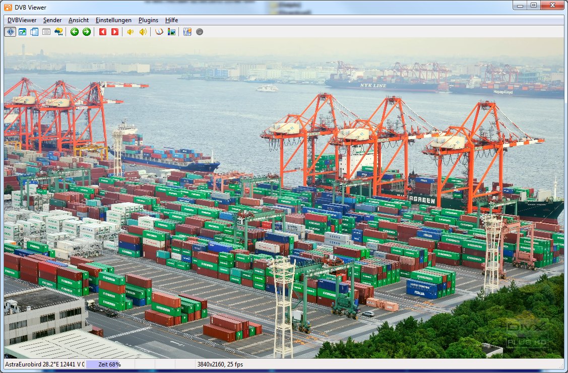

LocalHolgi Posted September 7, 2012 Posted September 7, 2012 Ja, oder eine Grafikkarte die das kann. Ich hab hier mit DivX Dekoder (andere gehen irgendwie gar nicht) eine CPU Last von 10%. Bei normalen 720 oder 1080 HD liegt das hier bei 2% oder weniger. Meine GTX 465 kann die Übertragung 1a darstellen, allerdings habe ich keinen Monitor der die Auflösung auf die Reihe bekommt. Quote

Griga Posted September 7, 2012 Posted September 7, 2012 Der H.264 Videostream alleine belegt auf dem Transponder ca. 40 MBit/s. Drei Minuten Aufnahme ergeben 863 MB. Das ist allerhand. Wer mit dem Begriff "4k-Signal" nichts anfangen kann: Das ist UHDTV (Ultra-HDTV) mit 3840 x 2160 Pixeln. Quote
Griga Posted September 7, 2012 Posted September 7, 2012 I'm getting buffer oveflows that cause interruptions with the DVBViewer Pro filter and this transmission ...which means, decoding is too slow. Quote
strs65 Posted September 7, 2012 Posted September 7, 2012 Thanks! What I don't understand is that I don't have those buffer overflows and interruptions with SmartDVB and AltDVB. Is there something I could try, or do I need a more powerful PC (something which is in my plans anyway)? Quote
Griga Posted September 7, 2012 Posted September 7, 2012 I don't have those buffer overflows and interruptions with SmartDVB and AltDVB. Other kind of error handling. What you can try: Start a recording and then play the file while it is recorded. Reading from a file doesn't require catching up with the broadcasted data rate. Quote
strs65 Posted September 7, 2012 Posted September 7, 2012 (edited) Other kind of error handling. What you can try: Start a recording and then play the file while it is recorded. Reading from a file doesn't require catching up with the broadcasted data rate. Nice one, thanks! It plays slowly too (I believe I can't avoid that) but without interruptions! Edited September 7, 2012 by strs65 Quote
