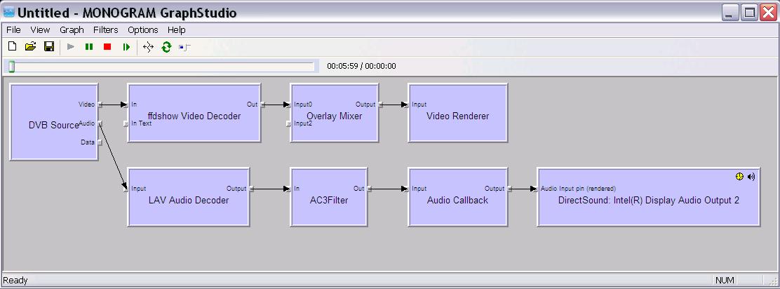

I'm attaching a screenshot of a filter graph in case it sheds any light for anyone with the necessary expertise (which I totally lack). The clip is of a broadcast movie, in .mpg format.
Does this give any clue as to why I'm getting no audio, or must the explanation lie somewhere else (such as in the configuration of one or more of the filters)?

All filters that don't provide a property page are greyed, because the menu item has no function.

Regarding the filter graph screenshot above, I wonder how and why AC3 Filter gets in there.
Since the LAV Audio Decoder does the decoding, AC3 Filter is working as audio postprocessor. However, if inserted by DVBViewer or the Postprocessor Plugin, the sequence should be different: Audio Decoder -> Audio Callback -> AC3 Filter -> Audio Renderer.
You can avoid AC3 Filter as (unwanted?) audio postprocessor by unticking Start Menu -> AC3 Filter -> AC3 Filter Config -> System Tab -> Use AC3 Filter for PCM (DVBViewer should be closed).
