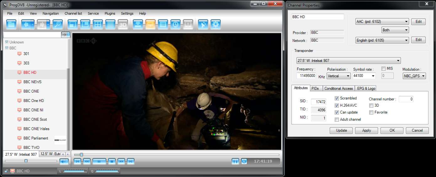

rizik29 Posted December 9, 2012 Author Posted December 9, 2012 I've attached files to show what can be seen on same transponder with ProgDVB and what can (not) be seen with DVBViewer. Strange, considering that lyngsat and kingofsat is run by people who don't know anything about satellite technology and DVB, maybe DVBViewer team can explain to them benefits of black screen.
