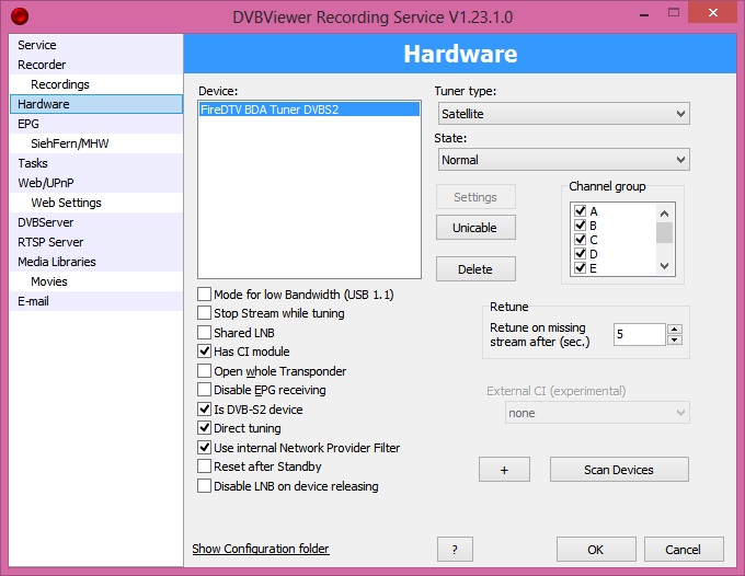

entrecour Posted January 19, 2013 Posted January 19, 2013 majstang, Sorry to hear that you are still having discontinuity problems. I am still using a Firedtv tuner with no discontinuities. In fact I would say my experience has improved significantly over the last 12 / 18 months but I put that largely down to improvements in LAV, and tweaking DVBSource parameters although I haven't tested with older versions of DVBViewer to see is that assumption is correct. I used to have big problems with high (30000) symbol rate HD channels on Thor but not anymore. By the way what is the FloppyDTV driver version that you are using? I am on 5.0.6326.3001. Are you using the latest firmware? The only place I think you can get these now is on Tystpc. FYI I have attached a screen shot of the DVBsource window. Quote

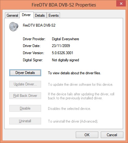

entrecour Posted January 19, 2013 Posted January 19, 2013 (edited) The version I am using is dated 23/11/2009 - that's the date from the driver tab of Device Manger, that's where I also got the driver version from. There may even be a later one - I saw a reference to that possibility here but the link provided was dead. If you manage to get hold of it let me know. Edited January 19, 2013 by entrecour Quote
entrecour Posted January 19, 2013 Posted January 19, 2013 Here are the driver details from Device Manager. I am on W8 Pro 32 bit. Quote
