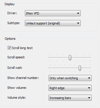

I uploaded an update:
  • Added a new option to switch off left/right scrolling of shorter text and set it to continuous scrolling.
It works perfectly, thanks SnoopyDog :beer: ....

I uploaded an update to the first page:
Update 12.11.2015:
  • Added localization to the settings page. Current languages are German and English.
  • Restructured initialization and shutdown code.
  • Some small fixes.
  • Better compatibility with new DVBViewer versions.
