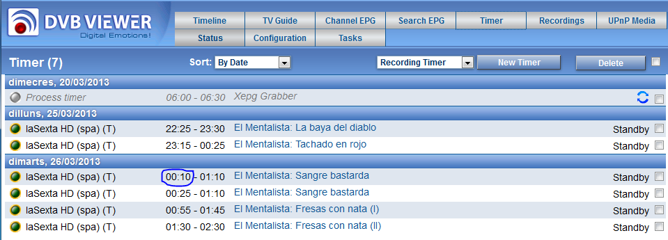

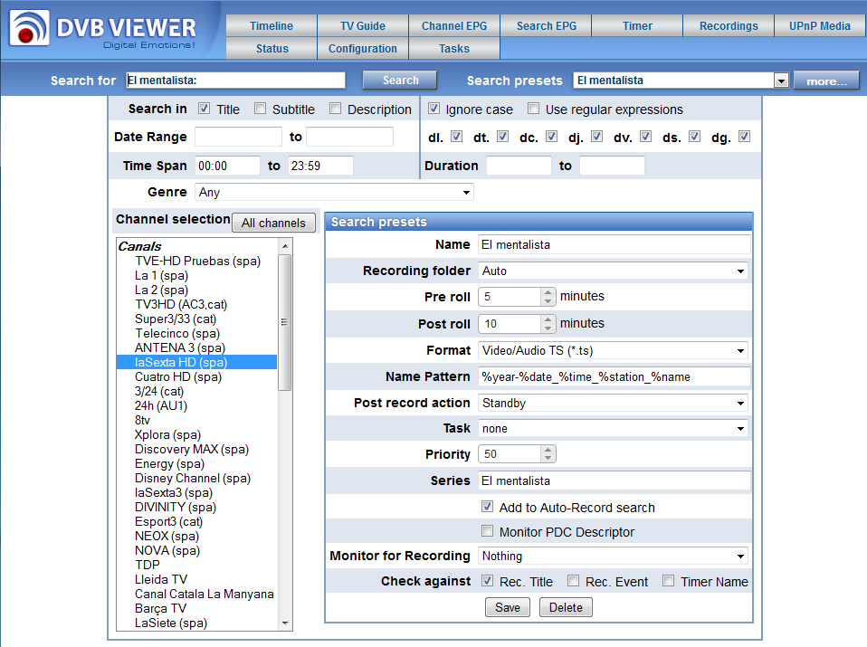

It is the series recording. I've tried the autotimer with search presets, but there is a problem with the updates.

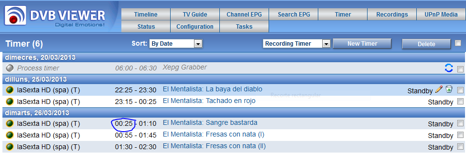

For example, if one record starts at 1:25 and after it changes to 1:10, it doesn't change in records: it adds a new record, but doesn't remove the old. And also, if one serie is deleted in the epg, it doesn't propagate to the records.
I think that one solution is to remove completely all the timers with the search term and add the timers after the autotimer search.
You can see what I want to say in the images below.
