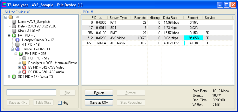

Griga Posted March 23, 2013 Posted March 23, 2013 Can DVBViewer support this in the future? Don't know. We can try... Can you provide a TS sample? Record it with TransEdit. It should contain video, audio, PAT, PMT and SDT. Do you know - if specifications about AVS+ and the embedding in transport streams are available? - if there is a DirectShow video decoder that is able to decode AVS+? That is basically what we would need for a start... Quote
gqsun Posted March 23, 2013 Author Posted March 23, 2013 hi, thanks for quick response. I recorded a 3mib file, where should I send it to? I can't attache more than 512k of file in the forum Quote
gqsun Posted March 23, 2013 Author Posted March 23, 2013 hi, also I think the decoder is included in ffdshow, known as "chinese avs". Quote
Griga Posted March 23, 2013 Posted March 23, 2013 I recorded a 3mib file, where should I send it to? 3 MB will be enough for a first check, but if we find a possibility to make video playback work, a longer sample (approx. 10 seconds) may be required. For upload please read the personal forum message that I have sent to you. Quote
gqsun Posted March 23, 2013 Author Posted March 23, 2013 hi, the sample had been uploaded, and a private msg with resource links is also sent. thanks, and if you need longer sample I will upload it Quote
Griga Posted March 24, 2013 Posted March 24, 2013 Thanks.The sample enabled to add AVS video detection in TransEdit (see screenshot below). That was the easy part The stream_type in the PMT is 0x42. I don't know if it already found its way into the ISO 13818-1 specifications, but I suppose it is a unique ID because I have never seen it before in a TS.The AC3 audio stream is a bit odd, because the PES packet_start_code_prefix and stream_id are 00 00 01 C0, which is ok for MPEG or AAC audio, but not for AC3. According to the ISO and DVB specifications it should be 00 00 01 BD (private_stream_1). The wrong stream_id does not prevent playback in DVBViewer and TransEdit, but may cause other problems - see here. Maybe you can inform the broadcaster about it.Making the video play will be harder. According to Wikipedia VLC is able to play AVS, but no luck so far. I guess for testing video playback a longer sample (about 10 seconds) will be necessary. Can you upload another one?Here are the links that I got via PM, for everybody who wants to join the discussion:avs.org: http://www.avs.org.cn/fruits/en/softList.aspDirectShow filters: http://sourceforge.net/projects/avsdshow/ Quote

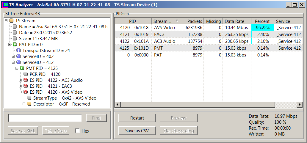

weisskreuz Posted July 23, 2015 Posted July 23, 2015 AsiaSat 6A 3751 H 07-21 22-41-08.zip 1.13 GB https://mega.co.nz/#!CoxRzYTL!TrJbjhDub2pVhvYe0boR5hAt3CsmHMpmlqTMlnuxtMw AVSPlus_Release.rar 210 KB https://mega.co.nz/#!i1YlRSLD!83JD-PXC_URzcuTbTskjNaiyPyHSPbd0X3QNp4zmMOs AVSRelease.rar 6.9 MB https://mega.co.nz/#!i4ZyUCQB!XrfD3PW_KUpLEp91a9g9ppfHFZbm26sDLAkef4j9Cnw Quote
Griga Posted July 23, 2015 Posted July 23, 2015 AsiaSat 6A 3751 H 07-21 22-41-08.zip 1.13 GB The site prompts me to install a "browser extension" for downloading. That's something that will never ever happen. Quote
Derrick Posted July 23, 2015 Posted July 23, 2015 I could download the recording with Chrome. Dunno how to proceed with the filters from the AVSRelease. Transedit does recognize the stream type as AVS but of course only the audio track works in preview. Same with VLC. A screen shot from AVSRelease: Quote

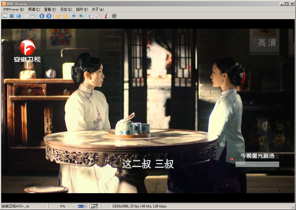

SatDream Posted August 19, 2015 Posted August 19, 2015 Hi, the AVSRelease filters coud actually decode the AVS+ video.with normal video player. No need to use the avsplayer included. The method introduced by the compiler for this avs+ decoder 3.0 is like this: Open the filter folder Run the register.bat with administrator right (mouse right click) to register the specially complied LAV filters provided by the AVSRelease filters to windows\system32. The content of the register.bat is to register following special LAV filters. cd /d %~dp0 regsvr32 LAVAudio.axregsvr32 LAVSplitter.axregsvr32 LAVVideo.ax These have been tested with MPC-HC (Media player Classic-Home center 32bit version.) (Not working with 64 bit version) You have to replace the MPC-HC LAV filters with the filter packs inside the AVSRelease files. (I just put all the files to MPC-HC LAV filter folder for replacement. I have also tried with DVBViewer to play back AVS+ video after registering the special LAV fiters, it only works for up to version 4.8.0.1 with 32 bit Windows 7. (Not working for DVBViewer with higher version than 4.8.0.1) (I have saved some previous versions of DVBViewer since I brought the software.) Actually the AVSRelease filter packs could work in most video player like potplayer, only to select the filters to use LAV filters for playing back and replace original LAV filter with the AVSRelease LAV filters. The problem with DVBViewer for realtime decoding the AVS+ live stream is probably is as you have suggested for connecting the DVBViewer Filter (required for live TV playback) to an AVS video decoder.( AVSRelease LAV filters) (As at present, DVBViewer source filter could not select external filter for realtime live TV playback, only palyback mode for recorded video could select these filters for playing back.) If DVBViewer could allow source filter to select these special LAV filter for realtime decoding the AVS+ live stream, these could be tried. In addition, may require about 1sec lag time to decode the AVS+ video by DVBViewer once play is pressed. (for 2500K CPU) I have also tried to live TV playback with DVBViewer, first of all, I have to use channel editor to manually add the correct VPID to the respective channel, as these AVS+ channel could not be correctly recognised by Transeditor for the VPID, these become "0" and grouped under radio. After descrambling, I could only see grey screen with audio for live AVS+ TV channel playback. But when recorded these live TV playback (already no preview as become grey screen with audio, I could correctly play back these recording with DVBViewer and MPC-HC etc with the special LAV filters. Hope Griga could work tthrough the way for live AVS+ TV playback. (maybe with some time delay to allow for slow CPU decoding). Thanks. Quote
SatDream Posted August 19, 2015 Posted August 19, 2015 I have also tried other dvbplayer programs whether could play the AVS+ video, all failed but only DVBViewer with version up to 4.8.0.1. DVBViewer latest version and other version up could not play the AVS+ video with the special LAV filters by AVSRelease. It seems only works for 32 bit windows and systems. There is one other dvbplayer that could play back the AVS+ video with the special LAV filters, but that dvbplayer could not scan all the channels for satellite 6A. Only resulting in few channels scanned for 6A, as this program has no support for 16-QAM modulation! Quote
gqsun Posted September 6, 2015 Author Posted September 6, 2015 hi, After waiting for such a long time, we finally see a little hope to get this working. I tried the filters, it did work, even on 64 bit windows. the required procedures to congiure these filters are: 1. register the filters (by running register.bat) 2. in dvbiewer, change all the mpeg2 decoder to LAV decoder, because this filter is a modified version of LAV now, We have some problems that need DVBViewer dev guys to help. 1. to play the avs+ video inside DVBViewer, you have to do one more thing, we have to disable DVBViewer filter for .ts file, once you disable it, video plays. 2. obviously we do not want to play avs+ video by DVBViewer, we want to watch satellite tv, but the problem is the DVBViewer filter, we don't know how to disable it. or if DVBViewer dev can updates it, it maybe able to split avs video 3, there is a proof that if we use the modified lav splitter, video playback works, I tried graphedit, and the video plays well, it uses modified lav splitter 4. we also have problem in channel scan and transedit, it must recognize AVS+ video stream pid, otherwise we have to manually enter it (DVBViewer says it's 0) with the above moniro updates in DVBViewer we'll be able to watch avs+ satellite tv in china. I am a registered user of DVBViewer and I recommend everyone I know to buy it. I really hope DVBViewer dev can help us. thank you. and of course, I can provide ts file if needed again. Quote

Griga Posted September 15, 2015 Posted September 15, 2015 Sorry, I'm a bit late... but I can give you a clear answer now: Provisional AVS+ support in the DVBViewer source filter (without format detection, just demuxing the data and passing it on) would be possible if I knew which media subtype is required for connecting to an AVS+ Decoder. Additionally It would take measures like integrating the new video type in the DVBViewer channel data and such - some work, but no big deal. However, it is quite obvious in this case that someone is using the LAV Filters framework for his own purpose without respecting the GNU Public Licence under which it has been released and without giving the original LAV author a chance to integrate the extensions into the main line of the project. I will not support this and I will not cooperate with it. I will only do it under the condition that the LAV licence is respected and the changed source code is made publicly available. That's all... nothing more to say about it at the moment. Quote
