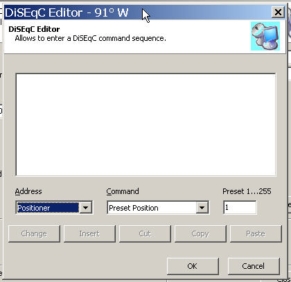

When one tries to add positioner and/or switch settings in the DiSEqC Editor, the option to Insert the row is greyed out. Am using the Genpix driver for my SkyWalker-1. This feature in DVBViewer Pro worked fine in version 5.0.

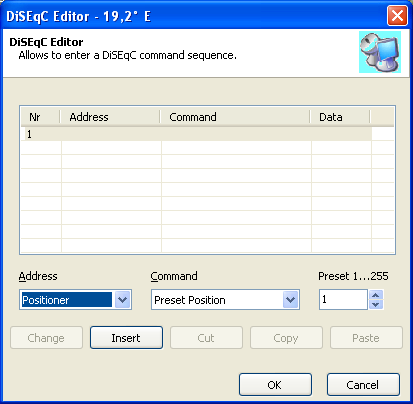

No problem here with Windows XP SP 3. Looks like the list that is supposed to appear in the blank area isn't displayed at all. At least the first line and the grid lines should be visible (see screenshot).
