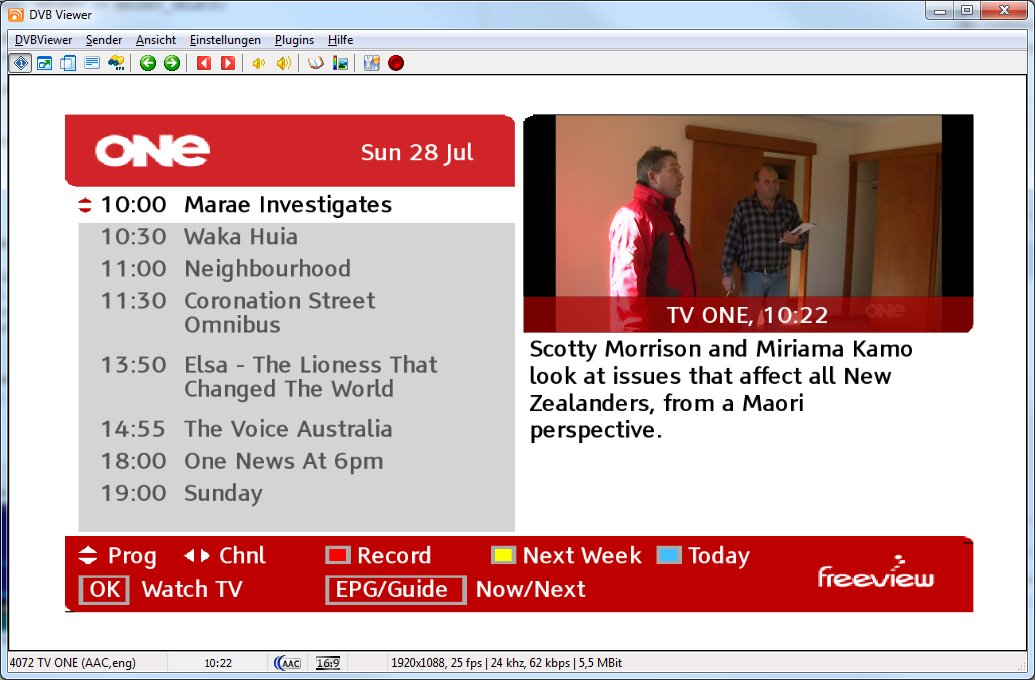

hackbart Posted July 28, 2013 Posted July 28, 2013 I forgot that nz does not handle their Mheg via F5, but with the EPG key. I suppose the problem was caused by an older mheg version inside the installer. It will be fixed with the next release. Quote
Kiwi_Tim Posted July 28, 2013 Author Posted July 28, 2013 Thanks Christian, I'll look forward to the next release of the MHEG-5 engine. One other question, does the MHEG-5 engine still work with the BBC iPlayer via the internet. I might be travelling to the UK and would like to set it up on my laptop. Do you just go DVBViewer Menu / 'Open URL', then paste in http://www.bbc.co.uk/iplayer/tv Many thanks, Tim New Zealand Quote
