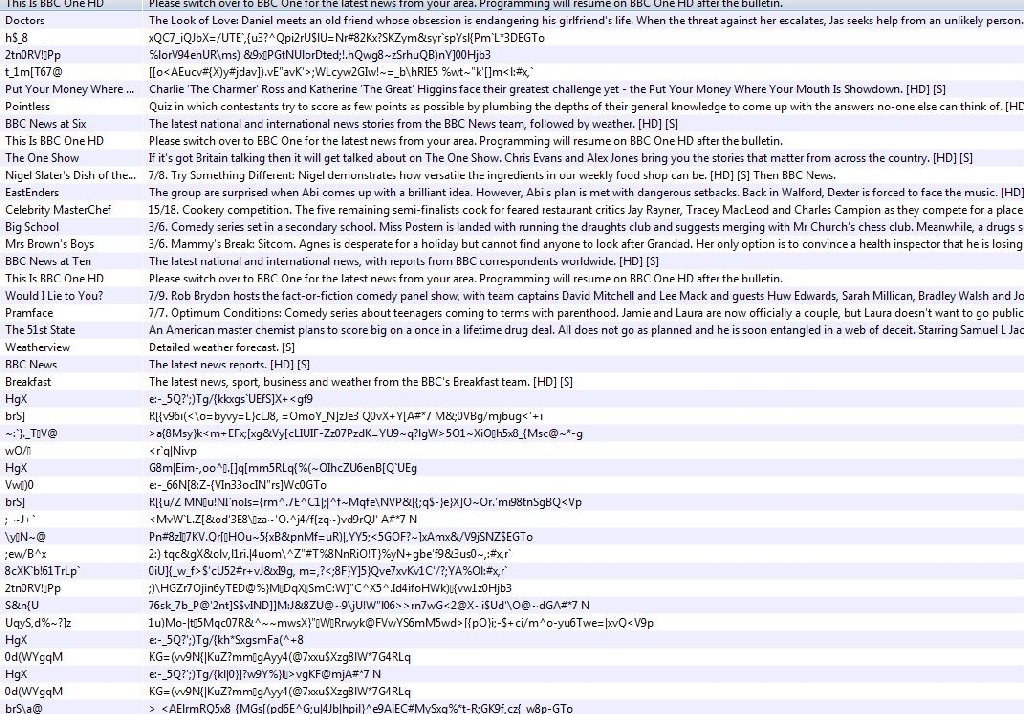

Hi there,
Many of the listings is my EPG (UK, Freesat) appear scrambled. I've attched an example (BBC 1) but they're all very similar.
I've reinstalled from fresh but no luck. Still happening.

Strange. It seems to happen from a certain point on.

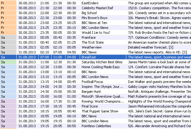

Unfortunately you've cut off date and time so I can't really compare it with my results that are ok throughout. In my screenshot I've marked the last entry that is ok in your screenshot.
I've collected the EPG data by switching to BBC 1 London and waiting for approx. 25 minutes (the slow way), and then again by deleting the file epg.dat and switching to Fashion One on 11427 H. On this transponder the whole Freesat EPG is broadcasted within 25 seconds.
Please delete the file epg.dat in the configuration folder (see start menu -> DVBViewer) while DVBViewer is closed. Does it happen again? If yes, in the same way?

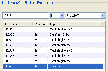

Receiving the high speed EPG on 11427 h (or 11428, shouldn't matter) requires an entry on Options -> EPG -> SiehFern/MHW (see screenshot). Is it present?
