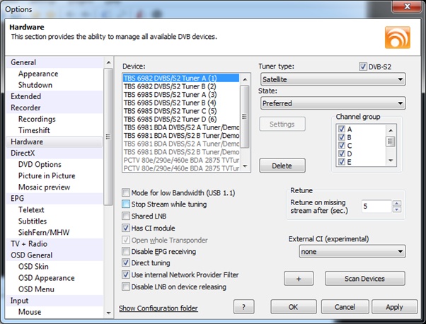

I've set 8 of the 10 to be enabled in DVBViewer Pro, and left 2 as "do not use" - I've selected devices 9 and 10, so the ones at the end of the device list.

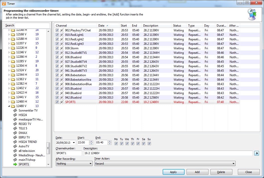

If I then set up recordings via Timer, to record multiple channels per transponder, and ensure I'm only using 7 unique transponders as part of this, the entries against first 6 transponders work fine, but the 7th goes Red in the timer.
If I enable device 9, it still stays Red in timer. Same is true if I enable device 10.

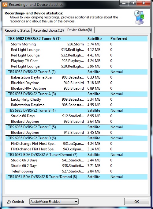

support.zip attached, and screen shots of timer and hardware. I've used Description column to denote the transponder and satellite so you can see that these are indeed only 7 unique transponders.

So whilst it shows entries in Red in the Timer list, system correctly records all the channels across the 7 transponders. This is true whether you set Audio/Video to disabled, or you're watching a channel on one of the transponders the recordings will occur on.
Therefore appears to be an issue with how Timer shows recordings vs how device allocation works.
