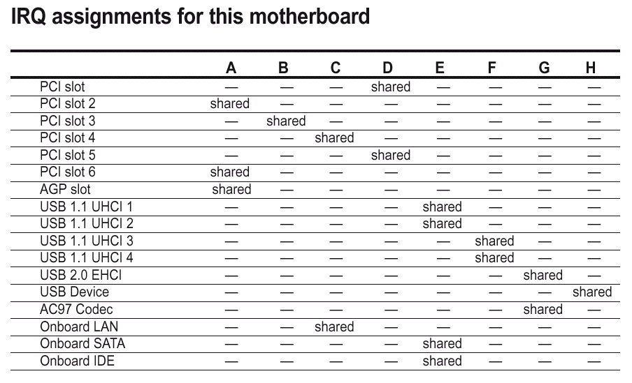

No, with the "slot near the AGP problem" we mean that usually that slot share the same "fisical IRQ" with the AGP; this easily can lead in poor rendering performance
Anyhow (as also arkon state) this isn't always a problem, it's depending on your MB...
Gioxy

I haven't excluded the problem of the overheating, I sat what wolud be the usual informatic meaning of the "slot near the AGP problem"....
For briefly explain what I mean: if you take a look on the manual of your MB you would have to find a "IRQ mapping table" (like the one I attach in this post), where you can notice that the AGP IRQ is shared with the one of the slots 6 and 2...
So I would avoid to insert the SS2 in slot 2 and 6...
