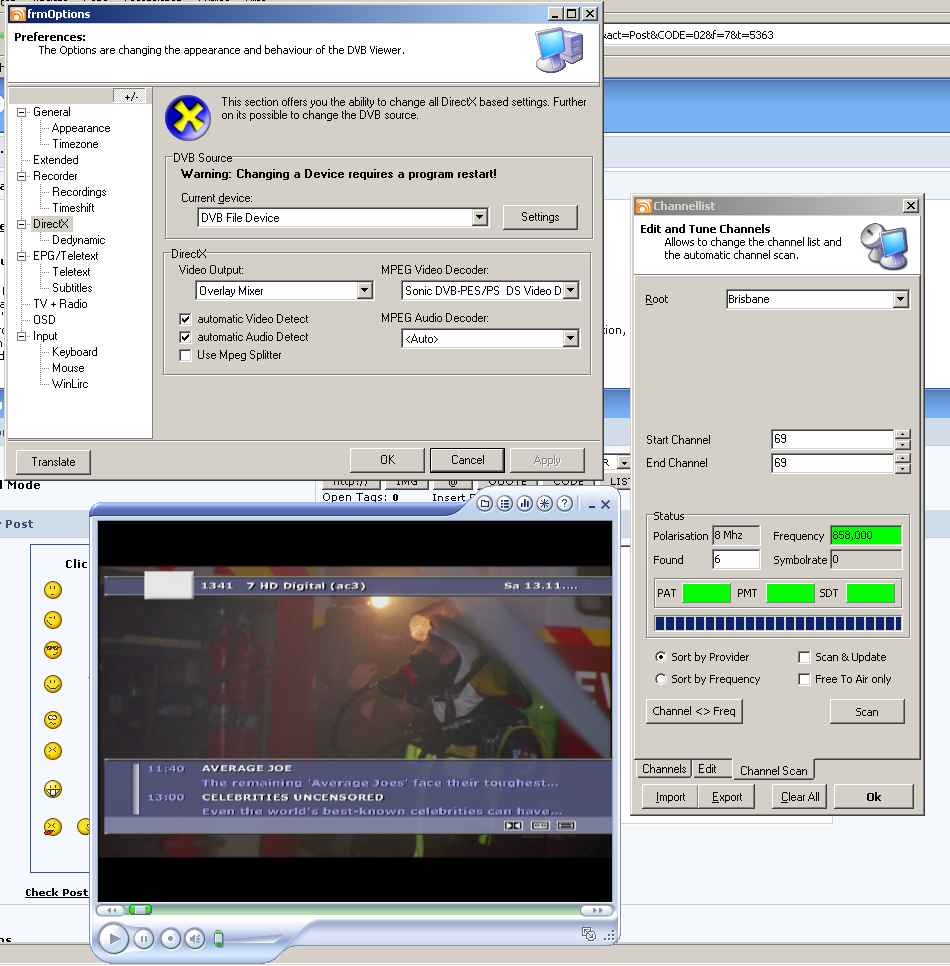

Guest hackbart
The reason is simple and easy to reproduce. Take a look into the australia.ini there are some frequencies missing. It seems to be that the file is a bit outdated. You can easily solve this by typing in a name on the root combobox instead of selecting a channel list.
I will update the ini file with probably correct channel freqs. In theory the frequencies are the same like in europe, but the bandwidth of each channel is 7 Mhz (UHF and VHF) instead of 8 Mhz for VHF in Europe..
The attached screenshot is a wip of the current internal beta. This one allows even to "emulate" DVB cards, so i'm able to play with exotic streams in practice.
