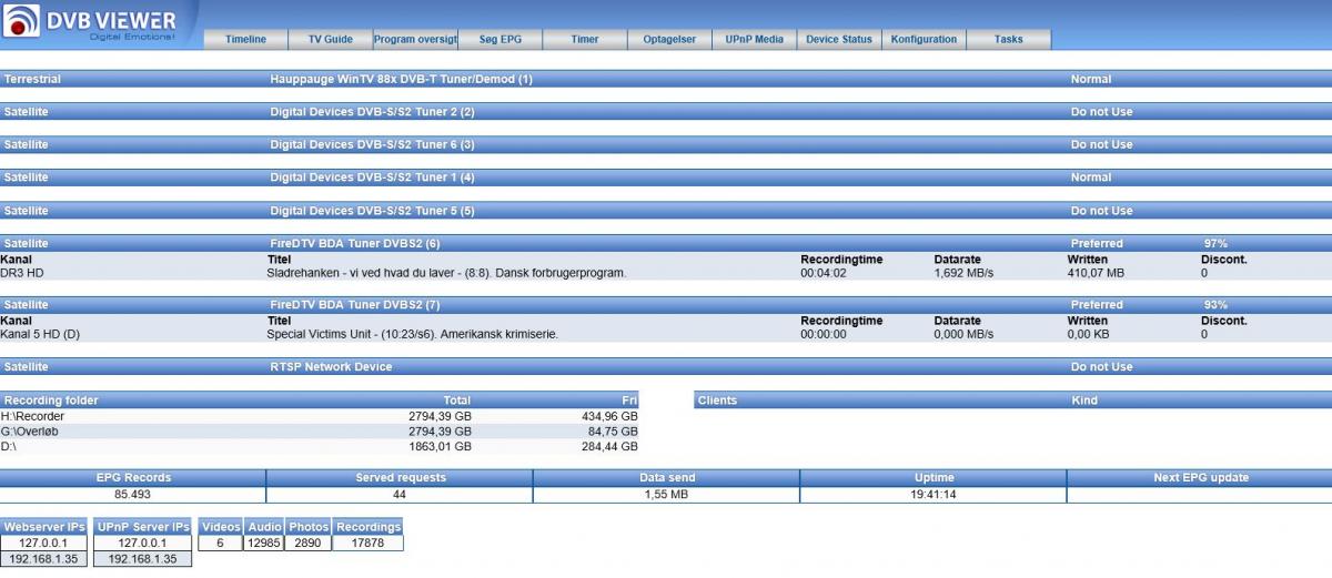

McenterFreak Posted December 17, 2013 Posted December 17, 2013 (edited) I got a very strange problem Some times my Recording Service dosent encrypt my recordings, resulting in hundreds of small files. It was always the same tuner, so i tried to disable it, but then the other tuner made excactly the same problem. So i enabled the tuner again. The funny thing is that if delete the timer and tune the same channel/program from a client, it works perfectly ( i have checked that excactly the same tuner is used in RS) I have atached Support.zip from RS server support.zip Edit: I use Smartwii to share my Subscription Card between my three tuners Edited December 17, 2013 by McenterFreak

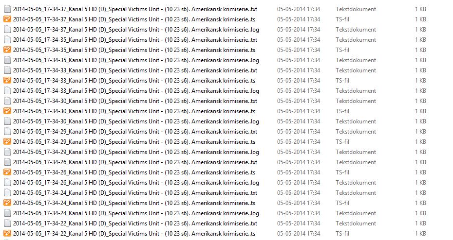

McenterFreak Posted May 5, 2014 Author Posted May 5, 2014 (edited) I would like to open this problem again, because it's a huge problem for me. On some channels i can't do recordings from RS, but i can view the channel from DVBViewer without any problems I have made a small test on my RS server This is the channel i used: I made a timer from RS RS starts to record, but no data is written: I look in the recording folder. Thousends of small files ar written: I stop the Recording I start DVBViewer. Tunes the same channel (using the virtual tuner from RS): I can now view the channel, without any problem: Support.zip atached: support.zip Edited May 5, 2014 by McenterFreak
krasno Posted May 5, 2014 Posted May 5, 2014 I don't know.. below what I think: When I experienced the same, and God knows I got grey hairs for months... it was always somewhere in my set up, nó matter I always first blamed Recordservice to be faulty, but..I always had to eat my own words. Record Service is incredible stable..!! Somewhere in your set-up, antenna signal (1% is enough to make some channels unstable) Smart-wii? ( if you have that?) have you checked DVB source under View? when the error occur? defect CI? Tuner is faulty,,? TT-S2 here can not receive high symbolrates anymore.., don't ask why, ..that's the way it is, once it worked, now it don't, but all channels work, and some days also the high symbl rates.. Codecs? re-scan all transponderlists in Transedit -delete the old.. find new , scan again... SOMETIMES everything looks fine, and a new scan of the transponder solve a problem.. don't ask me why.. something is wrong somewhere, and it is not a bug in Recordservice, but a problem somewhere in your set up.. Best and sometimes the fastest thing to do is to start all over..re install ..be course the reason is not to find.... (definitely not funny I know...) hope you can use at least some of it.. ..good luck..
Derrick Posted May 5, 2014 Posted May 5, 2014 Thx for your help @Krasno, but I think @McenterFreak should start with a fresh installation. What I can see is a total mess @McenterFreak, your RS is trying to tune with wrong PIDs. When you tune with the DVBViewer the PIDs are different (and correct) that's why you can watch the program
McenterFreak Posted May 5, 2014 Author Posted May 5, 2014 Thx for your help @Krasno, but I think @McenterFreak should start with a fresh installation. What I can see is a total mess @McenterFreak, your RS is trying to tune with wrong PIDs. When you tune with the DVBViewer the PIDs are different (and correct) that's why you can watch the program Okay, I try, Again, to make a fresh installation. But why does RS use a wrong PID? I thougt that DVBViewer and RS used the same Channel.dat, if they are on the same machine?

jirim100 Posted May 7, 2014 Posted May 7, 2014 ... It's true that RS doesn't update wrong channel data. RS uses a copy of DVBViewer's channel list. As long as the RS isn't stopped and restarted this copy won't be updated. For a timer only a referrer (channel_ID) is sent but not the PIDs. Hence wrong PIDs in the RS channel list will result in short ts_fragments containing only PAT/PMT. IMHO this mechanism needs a fix For example cable broadcaster UPC Czech republic broadcast on frequency 170.5 MHz (QAM 64) informations for tunning set-top-boxes. Maybe this (and similar) can be used Recording service for repair wrong PIDs when are recorded short ts_fragments containing only PAT/PMT. Occasionally broadcaster changes (without warning) PIDs for video/audio and then timer is not recorded. And when timer is not recorded then I am VERY VERY unhappy.

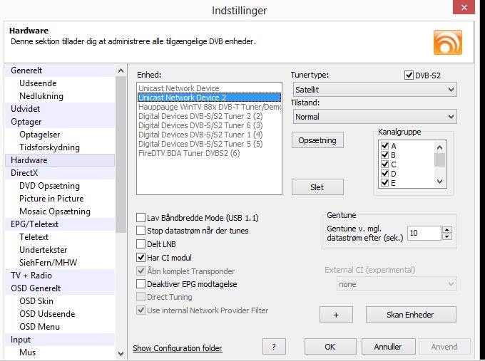

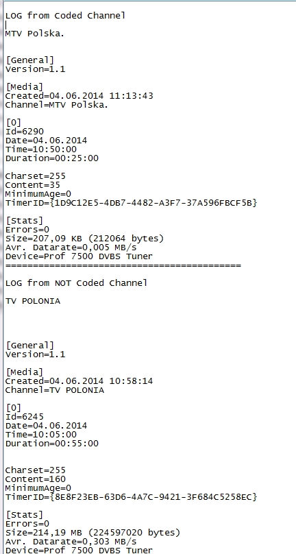

andemanone Posted June 4, 2014 Posted June 4, 2014 (edited) Hello for everybody experience that .Thas happened to me I use succesfully over many years tuner prof revolution dvb-s2 7500 usb and I installedThe newest DVBViewer_setup_5_3_1 and all additional featureslater I started to record programs directly from DVBViewerGoing to DVBViever->TV/Radio->Timer Recording and usingdate and starts and channel list easily you record all programed recording.Using EGP window I tested and programmed for futher recording and as well all is working perfectly .Not so long ago I installed svc_setup_1.29.0-and when I actived DVBViever Recording service 1.29.0 Beta I experienced what follows:1. Coding channelsIn this recording service automatically splits a recording into many many pieces into small size every 2 minutes and I'm not able to playback this by any player is not readeable2.Not Coding ChannelsIn this recording service ther is no any splits of recording into many many pieces and all workong perfectly.So if I can say DVBViever Recording service 1.29.0 Beta is very good program with absolutely the best web interface for recording not Coded channels.What to do and what kind of arrangements to be done in order to record coded programs without spilitting on small not readeable video files.?RegardsAndemanone Edited June 4, 2014 by andemanone
Derrick Posted June 4, 2014 Posted June 4, 2014 What to do and what kind of arrangements to be done in order to record coded programs without spilitting on small not readeable video files.? According to the policy on this board you'll need a CI which your card doesn't have.
