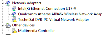

dvbrewer Posted December 23, 2013 Author Posted December 23, 2013 OK so I uninstalled all the Technisat software, uninstalled the card in Device Manager, then rebooted, selected the Software & Driver option from the Technisat CD, answered "Yes" to the question about IP services, now I have this- see attached image, what should I do....? Quote
dvbrewer Posted December 23, 2013 Author Posted December 23, 2013 (edited) OK, so I installed the driver for the Skystar on the CD via Device Manager, now the Technisat tray icon shows green - signal OK (previously showed yellow ?), and I have two devices in DVBViewer: Technisat BDA Digital Tuner & Skystar Express 2 HD. It also auto installed DVBViewer TE2, I presume I can uninstall that? Edited December 23, 2013 by dvbrewer Quote
Griga Posted December 23, 2013 Posted December 23, 2013 and I have two devices in DVBViewer: Technisat BDA Digital Tuner & Skystar Express 2 HD. The latter is the WDM driver. Set one of them to "Do not use", because you can't use both at the same time (DVBViewer doesn't know...) It also auto installed DVBViewer TE2, I presume I can uninstall that? Yes (except if you want to check for comparison how it works), but don't uninstall the other TechniSat software, because DVBViewer needs some of the components for connecting to the WDM driver. However, you may remove the tray tool from the autostart (Setup4PC or Server4PC). It is only required for internet via satellite. Quote
