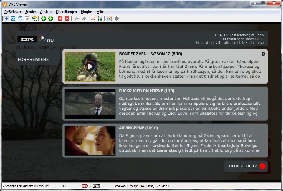

The problem is, that the first time I start DVBViewer and press the RED button (F5 on keyboard), then I do get into HbbTV info from Danish Radio (channel HD DR1) and I can move around in the menus. But if I leave the HbbTV again with F5, then I cannot enter it again. Even if I tune away from the channel and back again, then nothing happens when pressing F5.

I can confirm this weird behaviour at the page. It runs fine (incl. playback of streams and content) till
you press F5 at the moment the message appear "Tilbage Til TV" and you exit the page with F5 the application is terminated. I suppose this is because of retuning tv in a way the HbbTV engine does not recognize. I will try to debug this with the embedded javascript debugger.
The drnuApp.js seem to hide the display once F5 is pressed, but unhiding does not work. To be honest their source is quite hard to read ;)
