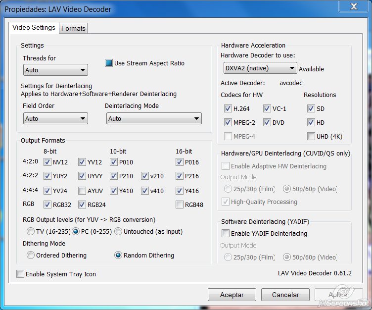

I have installed DVBViewer with LAV Filters. I don´t have any other codec installed, neither any other software.

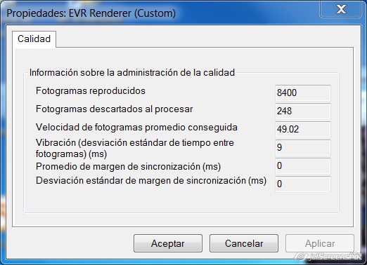

When I see a TV channel in HD (720p 50fps) in window, there aren´t problems. All works fine. EVR Render shows 50 fps.

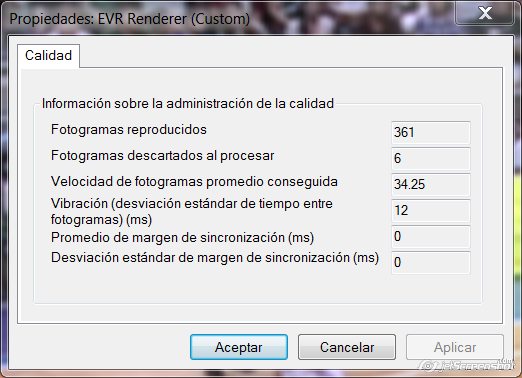

But if I switch it to full screen, the video slows, and lost synchrony with the audio. EVR shows 38-39-40 fps, but it can´t achieve the 50 fps. DXVA is enabled in LAV, and the cpu is not charged.

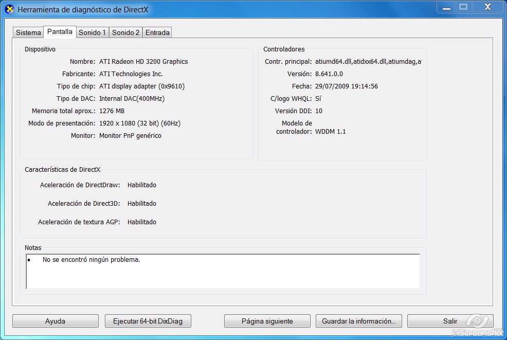

I have a Samsung FullHD panel thru HDMI. My graphics are ATI HD3200 integrated in a Gygabyte motherboard. It´s configured at 60 Hz refresh. If I change it to 50 Hz it´s the same.
The configuration of ATI Driver is standard (predefined)

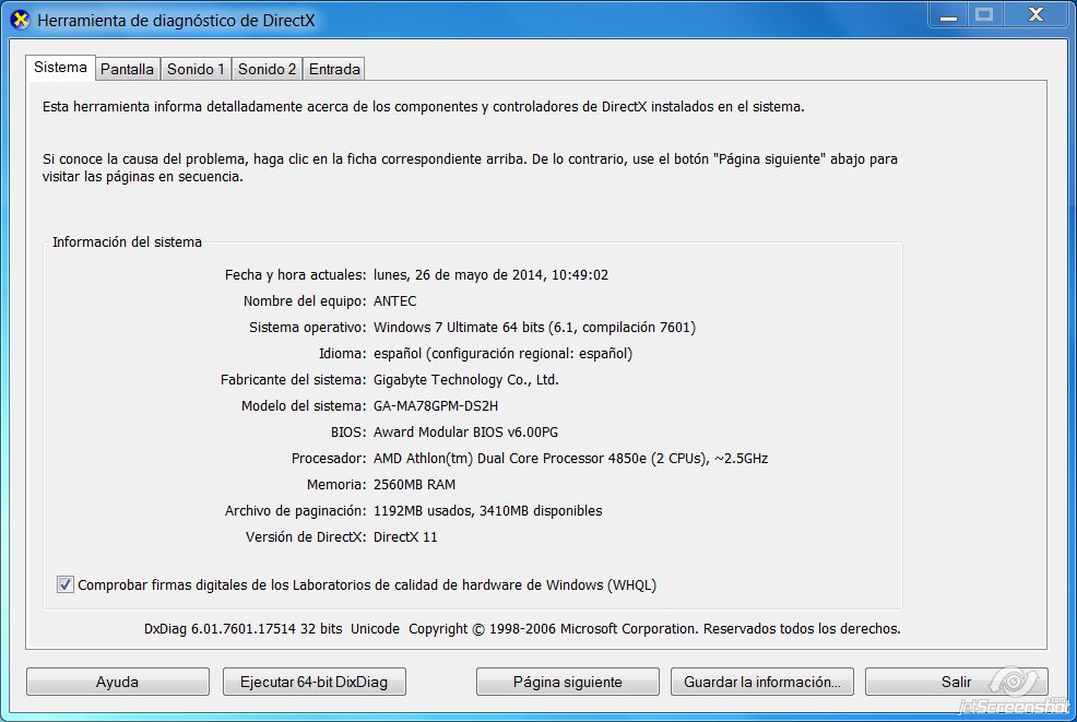

Motherboard: Gigabyte GA-MA78GM-UD2H AMD 780G
TV card: Hauppauge HVR-3000
ATI HD3200 integrated.

I attached some screenshots.
You can see how in fullscreen the video slows.

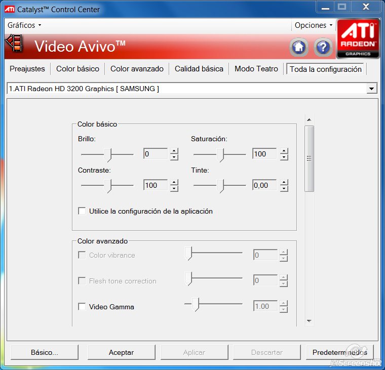

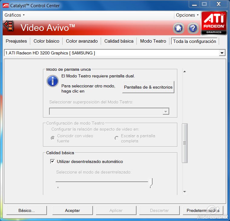

Yes, I know the integrated graphics aren´t the best solution, but in my HTPC I can play content in 1080p (with XBMC, MPC-HC). I only have problems in DVBViewer with TV-HD and in fullscreen.

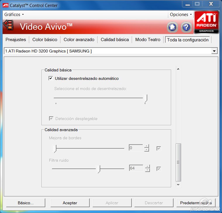

I have the CCC with standard configuration. I attached some pics with this.
Really is a hardware problem? Is possible that the problem may be with software (DirectX, etc...)?

LAV performs poorly on my HTPC. Even with DXVA enabled, it can't keep up with a 1080i stream. It's like watching half-speed video with lots of breaks when the buffers fill.
Microsoft native decoder is much better.
