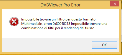

Hi All,
I have just installed DVBViewer 5.3.1.0 on windows 8.1 and I get the above error. When I click ok on the error dialog, I can ear the audio of the channel, but the video is black.
This happens with some channels, some others can be viewed fine.
I have read the other posts related to this issue, but I so far can't fix.
I have already uninstalled/reinstalled DVBViewer several times, same with DirectX. The video driver is updated to the latest version.
I have also installed ffmpeg codec.
Can someone please help to fix it ?
Thank you.
Edited by protexo
Windows 8 doesn't have a MPEG decoder. You need to install one. DVBViewer Pro downloader will get LAV filters.
This may not be your problem, since you can view some channels. Does Channel Editor show the video and audio types for the failed channels?
The channels that I can't see are:
Video Type: MPEG2
Audio Type: MPEG
The channel that I can see correctly are:
Video Type: H.264
Audio Type: AC3
Installing LAV filters fixed the issue.
Thank you |
