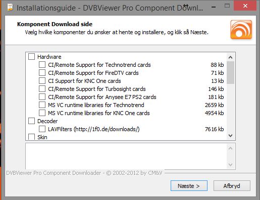

McenterFreak Posted July 8, 2014 Posted July 8, 2014 (edited) How can I setup DVBViewer Pro with no internet access? The machine in the educational lab and no internet access in this lab not even a wireless. When I install it in the normal machine it asks to access the website to download some components during setup, so how to complete the setup in case there is no internet connection? I think its because it want to download the additional files, that you asked for in your previous installation (Sorry, but is in Danish language): I tried to disconnect from the internet, and ignored this message, and all worked fine So you could just ignore this, then i think it just uses the "old" configuration (Codec etc.) Edited July 8, 2014 by McenterFreak Quote
MGadAllah Posted July 8, 2014 Author Posted July 8, 2014 My problem is the rule of the lab, NO internet (I want to kill the guy in charge for this lol). You mean at this point of setup I should click on cancel or hit the red X button on the top right of the window? and after that everything will be ok and application will be working fine as it should? In other words, does DVBViewer Pro working correctly with no internet access? I mean the setup and normal and daily usage of the application? does there is anything required or need to be provided for the application in case there is no internet. If this is the case, how shall I get a notification for later on update? Shall I do it manually and upgrade as mentioned in the other thread? Quote
McenterFreak Posted July 8, 2014 Posted July 8, 2014 My problem is the rule of the lab, NO internet (I want to kill the guy in charge for this lol). You mean at this point of setup I should click on cancel or hit the red X button on the top right of the window? and after that everything will be ok and application will be working fine as it should? Yes In other words, does DVBViewer Pro working correctly with no internet access? I mean the setup and normal and daily usage of the application? does there is anything required or need to be provided for the application in case there is no internet.DVBViewer don't need anything from the Internet to Work If this is the case, how shall I get a notification for later on update? Shall I do it manually and upgrade as mentioned in the other thread? Sign up to DVBViewer forum with your home e-mail, then you will be notified of new releases By the way, is it not it possible to bring out DVBViewer machine, and connect to the Internet, then bring it back to your LAB? Quote
