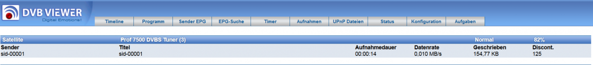

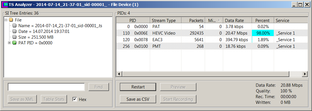

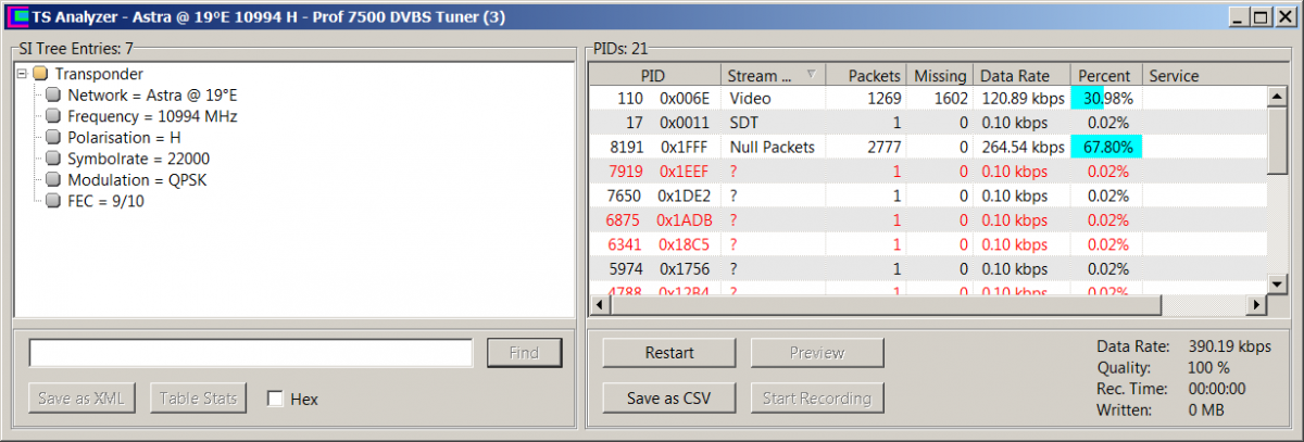

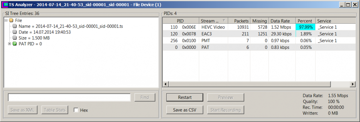

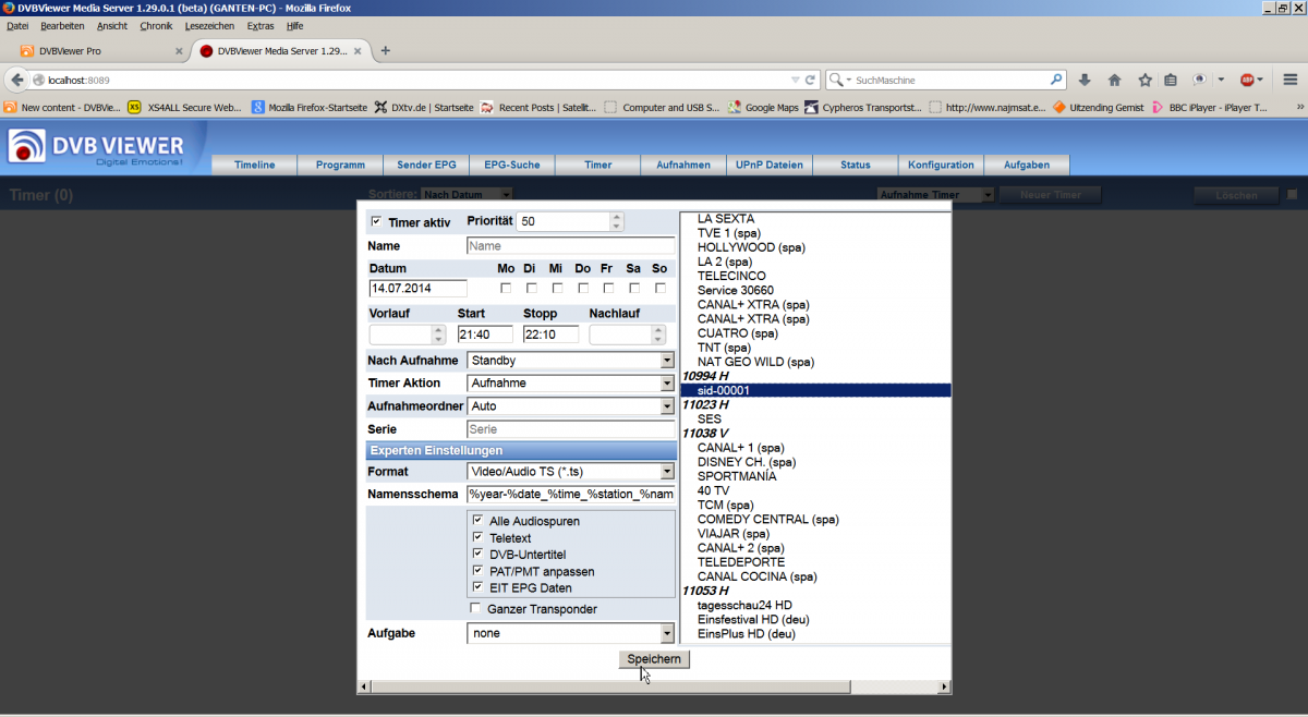

Derrick Posted July 14, 2014 Posted July 14, 2014 The processing power and transfer speed is not relevant for just recording any transport stream.There might be an issue. I've tried to record sid-00001 from 19E, 10995H. If I tune to this channel, I can watch the HEVC demo without problems (i7 ). Pressing the direct recording button will yield a perfect recording from the recording service. Also a timer programmed in the DVBViewer results in a recording without errors. But if I set a timer from the web interface the recording will be broken. I have no idea why this happens. Setting a timer in the web interface is a pain in the ass because the RS doesn't support favorites but for the test I've made an exception and caught possibly a bug 1st picture: direct recording and timer from dvbv 2nd and 3rd picture: timer recording in web interface Quote
Griga Posted July 15, 2014 Posted July 15, 2014 But if I set a timer from the web interface the recording will be broken. I can't reproduce it here. Are the discontinuities visible in the web interface -> status while the recording is going on or in the recorder log? Quote
Derrick Posted July 15, 2014 Posted July 15, 2014 It's getting even weirder.. After your post I tried again but couldn't reproduce it. Now I had a 2nd try and there it was again. After the broken rs_timer_recording the card (Prof7500) was locked up (analysing 11994H in transedit showed the same massive disconties). After tuning to a different transponder the card worked again. 15.07.14 14:38:52.379 TBDA_TBS Opendevice bvTurbosight15.07.14 14:38:52.379 TRecording AllocateHardware Prof 7500 DVBS Tuner (3)15.07.14 14:38:52.379 TRecording StartRecording Prof 7500 DVBS Tuner (3)15.07.14 14:38:52.379 TBDA_TBS SetTuner TType: 1, Freq: 10994, Symrate: 22000, LOF: 9750, Tone: 0, Pol: 0, DiseqC: 3, FEC: 9, APID: 120, VPID: 110, PMT: 256, SID: 1, SatMod: 5, DiseqCVal: 0, NID: 1, Flags: 2415.07.14 14:38:52.839 TBDACITBSModule CI Base SetTuner Entering15.07.14 14:38:52.839 TBDACITBSModule CI Base SetTuner Leaving15.07.14 14:38:52.839 TRecording StartRecording: sid-0000115.07.14 14:38:52.843 TRecordingEngine AddReference TRecording: 215.07.14 14:38:59.173 TBDACITBSModule WinProc Received PMT ready15.07.14 14:39:00.546 TRecordingEngine AddReference upnp webserver: 315.07.14 14:39:34.007 TRecordingEngine ReleaseReference upnp webserver: 215.07.14 14:39:37.970 TRecordingEngine ReleaseReference webserver: 115.07.14 14:40:10.779 TRecordingEngine AddReference webserver: 215.07.14 14:40:23.610 TRecording ($0ABD6F70) C:\TSRecordings\2014-07-15_14-38-52_sid-00001_sid-00001.ts Discontinuities: 1546 - Total size: 1,80 MB - Device:Prof 7500 DVBS Tuner (3)15.07.14 14:40:23.633 TRecording Release Prof 7500 DVBS Tuner (3)15.07.14 14:40:23.633 TRecording Destroy Prof 7500 DVBS Tuner (3) Quote

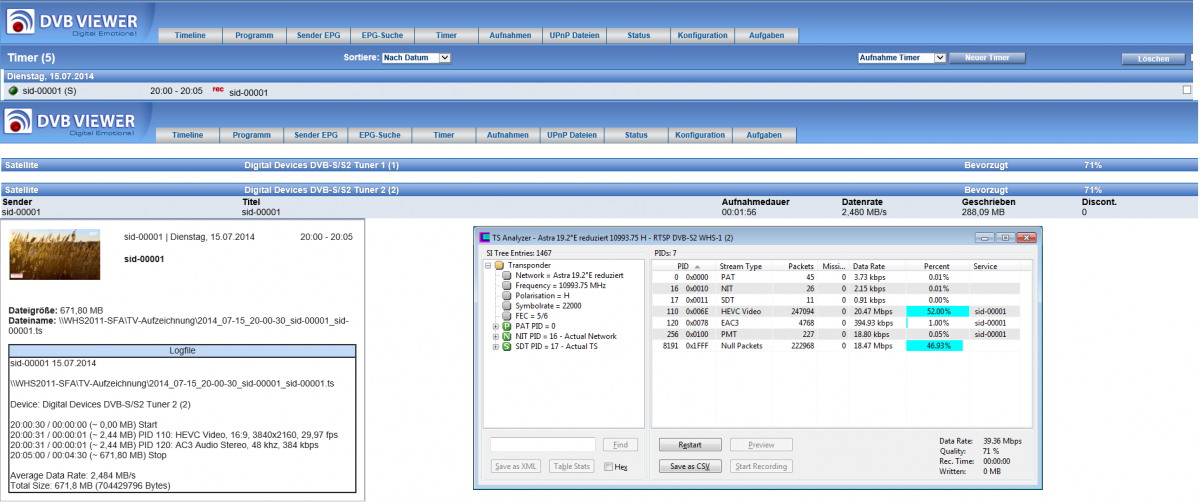

MaxB Posted July 15, 2014 Posted July 15, 2014 Possibly but there must be a difference in controlling the hardware from a timer set by the DVBViewer and a timer set by the web interface. No, I've just testet a recording of "sid-0001" with my buggy DD-Hardware (without "Ferritkerne" ) but have no errors loke Griga, too. Timer is set by web-if at 8:00:30pm (thats the reason for only 4min30 recording) Quote
