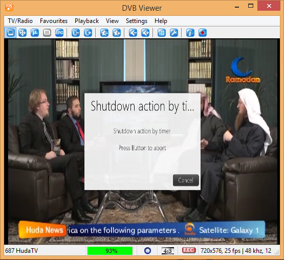

MGadAllah Posted July 20, 2014 Posted July 20, 2014 (edited) Hi, Please I would like to ask for your help and would like to know what to do to solve this problem. I set the recorder timer to shutdown the computer after the recording finished. But I am afraid it does not shut down the computer and give me this screen. So please advise and help me for what to do to completely shut down the computer as soon as the recording finished. I want shutdown to be done without any user interaction because no one will be set to the computer at this moment to hit any key in the key board. Thanks Edited July 20, 2014 by MGadAllah Quote
MGadAllah Posted July 20, 2014 Author Posted July 20, 2014 Just close the DVBViewer.. I do understand that but as I mentioned no one will be setting to the computer to do the shutdown manually and I do need to close it. As I mentioned in another thread that I am using Dell GX620 as a recorder client and access it remotely using windows remote desktop and transfer recorded files using ftp. But because I am recording all day long the full stream and 5 or 6 channels for this transponder streaming. So I would like to give the Dell GX620 computer some time to rest before recording the streaming once again. So I want to do the shut down as soon as the recording finished. Because I am connected remotely because no one will be setting to the computer at this time which lead to keep running for several days and the computer is over loaded. That is why I am asking about shutdown. Thanks a lot Quote
iks-jott Posted July 20, 2014 Posted July 20, 2014 You can choose here what DVBViewer shall do after recording. Quote
MGadAllah Posted July 20, 2014 Author Posted July 20, 2014 (edited) You can choose here what DVBViewer shall do after recording. That is what I did exactly my friend but it gives me the screen I've attached in my 1st post above. But it does not do the shut down directly. Edited July 20, 2014 by MGadAllah Quote
iks-jott Posted July 20, 2014 Posted July 20, 2014 My DVBViewer does close a few seconds after that screen that you attached. If I don´t cancel. Quote
MGadAllah Posted July 20, 2014 Author Posted July 20, 2014 My DVBViewer does close a few seconds after that screen that you attached. If I don´t cancel. It does not and monitor the computer for about 15 minutes after this screen appear but no shutdown at all. What is your windows operating system? mine 8.1 pro 32x Quote

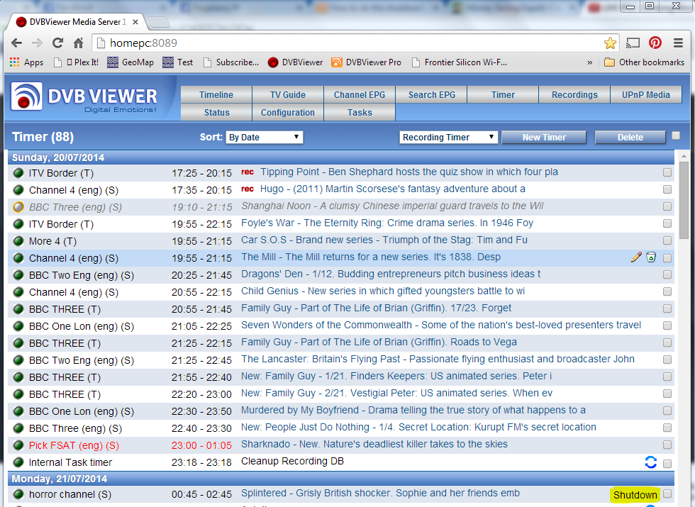

Lakeuk Posted July 20, 2014 Posted July 20, 2014 I use a shutdown task on the last programme of the night on my recording service, when the shutdown is enacted you'll get a user prompt like what you're seeing with a 30sec countdown, once it gets to zero then my PC shuts down. I'd recommend using the Recording Service rather than the DVBViewer client for managing you're recording Quote
