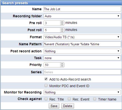

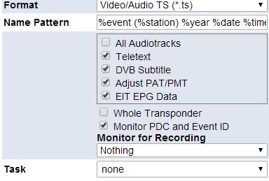

renzz Posted October 17, 2014 Author Posted October 17, 2014 Generally, this is working very well. For the channels that change the status accurately, it is starting the recording exactly as the program starts, and ends it in the right place as well. However, some channels in the UK do not do this very well - they tend to change status when the program *should* start (ie exactly at the start time) rather than when it actually does. For these channels, I have set my Search Preset NOT to use "Monitor PDC and Eventid" - but this has highlighted a bug. In the RS config, I have "Use PDC and EventID for EPG monitoring" ticked, and "EPG running status" selected: In my Search Preset, I have "Monitor PDC and EventID" unticked and "Monitor for recording" set to "Nothing": If I then manually run the auto timer task, it correctly sets the timers with those options. However....if I restart the RS service, it resets "Monitor PDC and EventID" on each individual timer back to ticked: It only seems to happen when the service is restarted (it may also happen when autotimer is set to run automatically but I'm not sure). So, looks like a bug...
Griga Posted October 17, 2014 Posted October 17, 2014 However....if I restart the RS service, it resets "Monitor PDC and EventID" on each individual timer back to ticked: Thanks for the report. Will be checked.
Griga Posted October 17, 2014 Posted October 17, 2014 Confirmed. When timers with "Monitor PDC" switched off are loaded the property is set to the default configured on the Recording Service Options -> Recorder -> Recordings page. The bug already exists in earlier versions. I think we can get it fixed in the upcoming 1.30.1 bugfix release.
