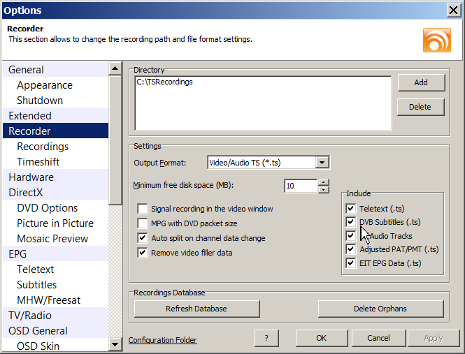

Derrick Posted October 19, 2014 Posted October 19, 2014 check -> settings -> options -> recorder -> DVB subtitles Quote
Tyro Posted October 19, 2014 Author Posted October 19, 2014 check -> settings -> options -> recorder -> DVB subtitles As I wrote I have tried to check all combinations there but still no subtitles in the recorded material Quote
