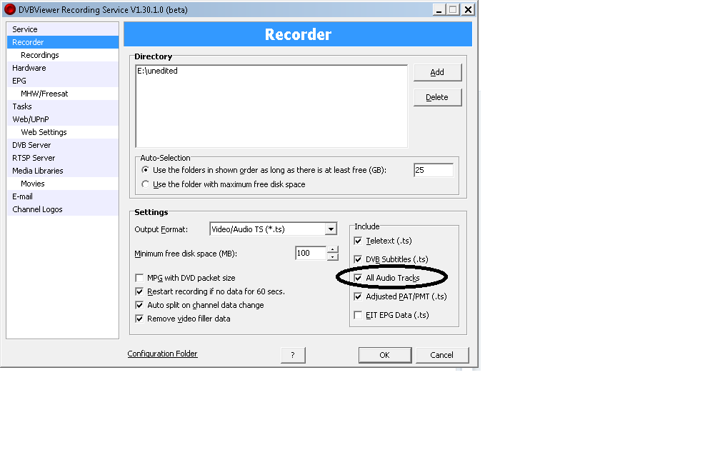

I have setup DVBViewer Pro with recording Service and using XBMC. There are channels that has multiple audio stream in different language. Since i am using recording service it automatically detects the default stream. So how can i change this audio stream in playback ?
Open DVPViewer Recording Service "Service Options"
under Recorder tick "all Audio Tracks"
then it should work... :original:

The setting is for UPnP clients.
If you use are using XBMC as UPnP client and not with the RS Plugin. Then this setting could help.
In UPnP clients you can only select the may channel.
But with this setting all audio tracks should be in the Video Stream.
So if the UPnP client aloud you to change the audio track. You could select a channel and then change the audio track.
But I don't know if that works. Or if there is any client which supports that.
At least with the DVBViewer Pro as UPnP client, it is not possible to select different audio tracks.
for the timebeing i just edited the audio pid in my DVBViewer channel editor so it will telecast the required audio
