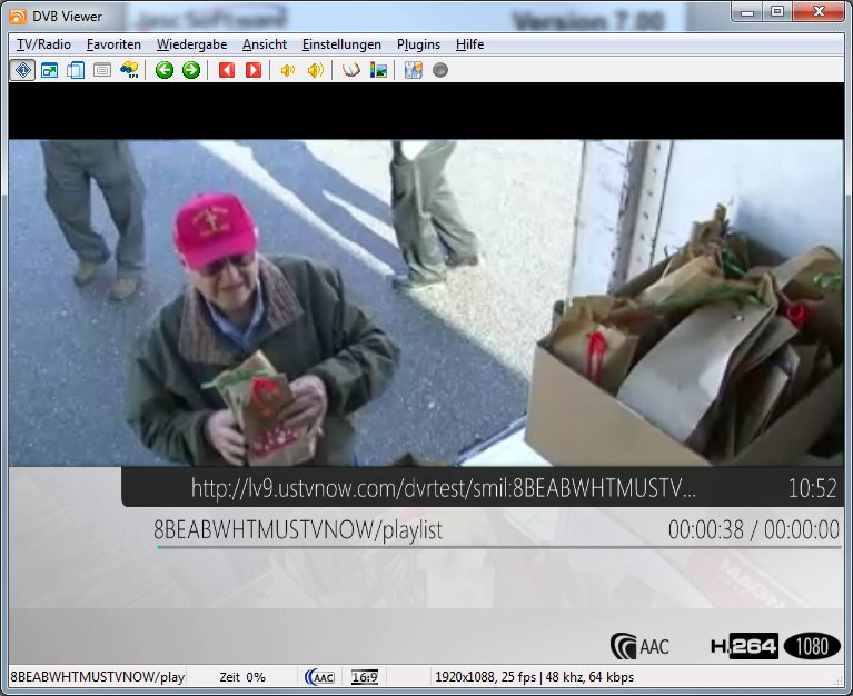

pennstat Posted December 8, 2014 Posted December 8, 2014 (edited) Hi, Was wondering if anyone has been able to get DVBViewer working with streams from https://www.ustvnow.com/ A free account gives access to a bunch of live channels, and there is a Kodi (XBMC) plugin that works quite well with it, if that is any indication that it might be doable. A google search reveals a couple of mentions and even a screenshot in a foreign magazine of it working, but I don't really know where to start. Ideally I would like to get this into the recording service in order to import the channel into XBMC's PVR interface, but simply getting it running in DVBViewer would be a great start. Thanks! Edited December 8, 2014 by pennstat Quote

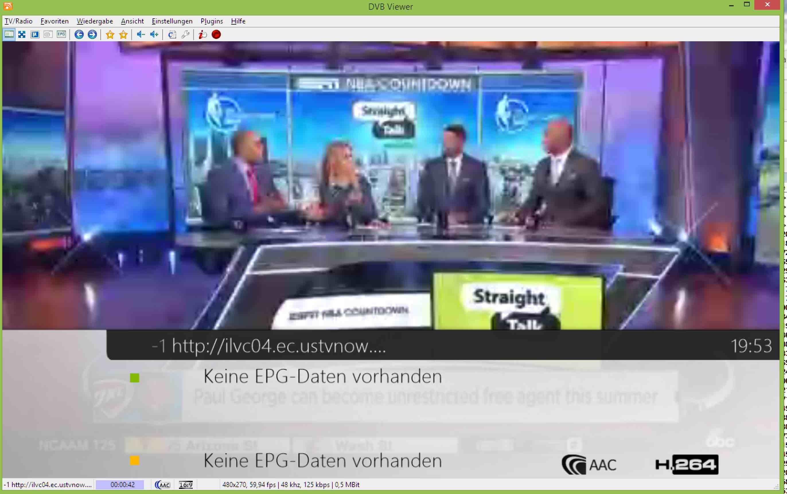

lehtikissa Posted February 4, 2018 Posted February 4, 2018 Yes, the streams work fine in DVBViewer (maybe the reason you're seeing such a low resolution is a temporary technical glitch in their servers). The issue is that as the generated stream URLs expire frequently (every 30 minutes?), the user experience is not optimal. Without being able to use M3U8s, one needs to manually update the URL in Channel Editor every time (which in practice makes it impossible to use DMS for recordings). Even if it was possible to use M3U8, it'd still require running a scheduled task every 30 mins to make sure the URL is active by creating a new M3U8. That's why the best solution would be the possibility of using a script in place of URL. It might be useful also for other use cases. Quote
