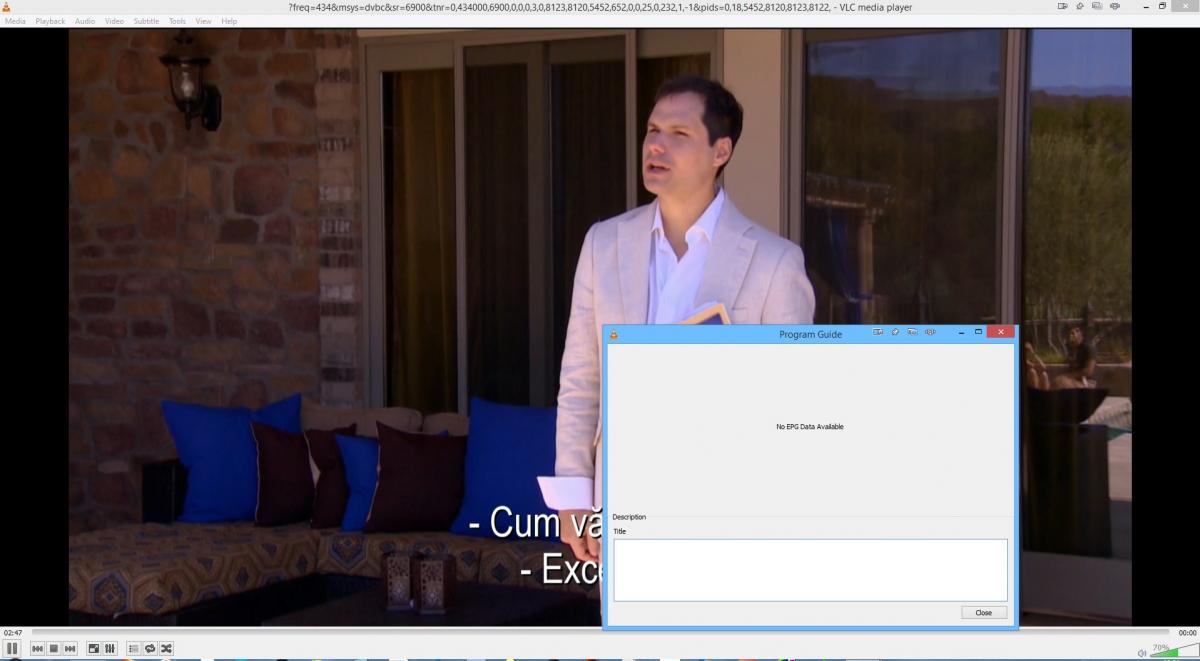

thor2002ro Posted February 10, 2015 Author Posted February 10, 2015 I just tried rtsp channellist in vlc Tools -> Program Guide is still empty and yes channel has epg... I can see it on the website...

thor2002ro Posted February 10, 2015 Author Posted February 10, 2015 the channel has epg... it shows up in DVBViewer... no idea what ETI EPG is... I'm new to this "dvb show" I left VLC program guide window open even for 1h... showed nothing...

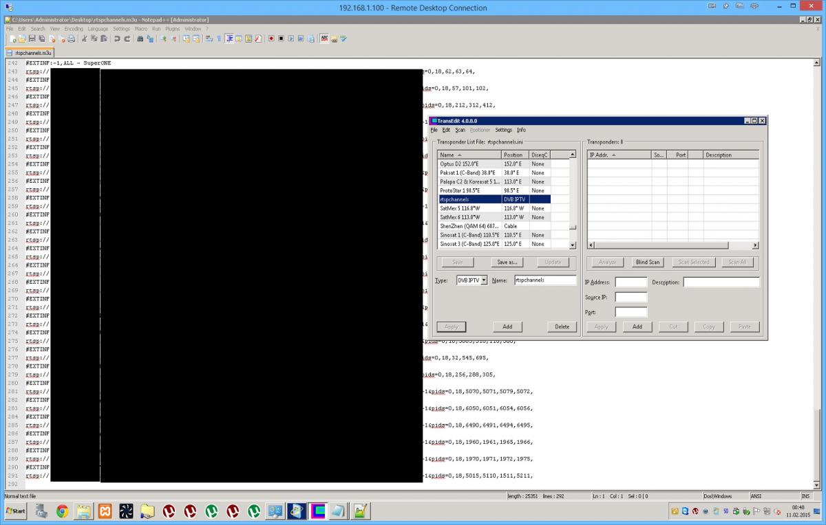

Tjod Posted February 10, 2015 Posted February 10, 2015 Download TransEdit Scanner & Editor 4.0.x (Members Section > Beta Section) put TransEdit.exe in the same folder as the DVBViewer.exe and start it. The drag and drop the rtspchannels.m3u TransEdit select one channel > click on Analyze Is there EIT in the Stream?

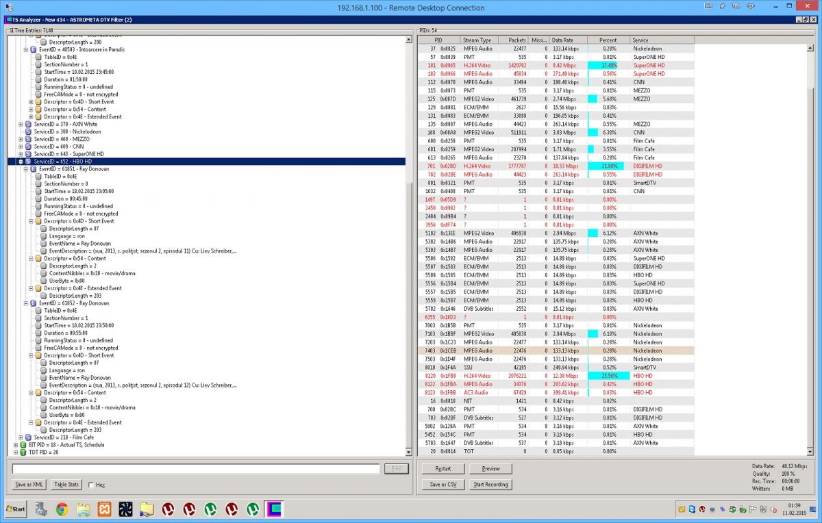

Derrick Posted February 10, 2015 Posted February 10, 2015 ..open the transponder 434MHz in transedit and check the analyser window. Can you see the events you're looking for in the left window of analyser under Actual TS (PID 18)?
thor2002ro Posted February 10, 2015 Author Posted February 10, 2015 (edited) I tried but it shows nothing on the list support.zip Edited February 10, 2015 by thor2002ro

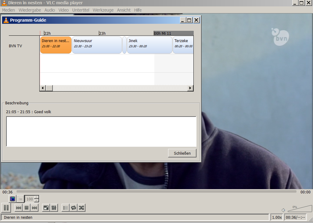

Tjod Posted February 10, 2015 Posted February 10, 2015 OK my fault it doesn't work in TransEdit 4.0.8 (but the next version will be able to Analyze play lists). Try the suggestion from Derrick Analyze the transponder from you DVB-C transponder list.

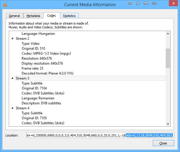

Griga Posted February 11, 2015 Posted February 11, 2015 Ok, I found out why it does not work. The VLC EPG additionally requires the SDT (PID 17). I've lately added it to the RTSP URLs in an internal RS version, but it's missing in the release. The RTSP URLs contain pids=0,18,... at the end. It should work if you manually change it to pids=0,17,18... You can try to change it in a text editor with "search and replace" for the whole list.
thor2002ro Posted February 11, 2015 Author Posted February 11, 2015 that works thanks looking forward to RS update

thor2002ro Posted February 23, 2015 Author Posted February 23, 2015 it doesn't contain the pid... but in vlc if you go to codec information you see the dvb subtitle with the pid there even if url doesn't contain it... the pid is named "original id" so I guess this metadata can be easily used to add subtitle pid into playlist generation here is an example
Tjod Posted February 23, 2015 Posted February 23, 2015 Yes the algorithm in VLC need to be improved.VLC is able to detect pid, but not to request pid which are not in the play list.VLC is only a Sat>IP "thin client" and not a real Sat>IP client (which are able to manage there channel list on its own).
Tjod Posted February 23, 2015 Posted February 23, 2015 One additional point, the RS doesn't know which channel a Sat>IP client is watching. It just forwards the pids requested by the client.
Griga Posted February 23, 2015 Posted February 23, 2015 but in vlc if you go to codec information you see the dvb subtitle with the pid there even if url doesn't contain it... It finds the PIID(s) in the PMT (Program Map Table). A true Sat>IP Client would not only display the possibility of getting a subtitle stream, but request it from the server as soon as the user wants to see it. VLC is not (yet) able to do it. DVBViewer is. Broadcasters often add subtitle PIDs dynamically to the PMT or remove it, depending on the broadcasted content. In this case it is not possible to know beforehand if and how subtitles are available. You need to understand that the PMT is based on a dynamic concept. "Static" clients like VLC can't adapt to it. Don't blame the server. Accept it or use software that is able to do what you want.
