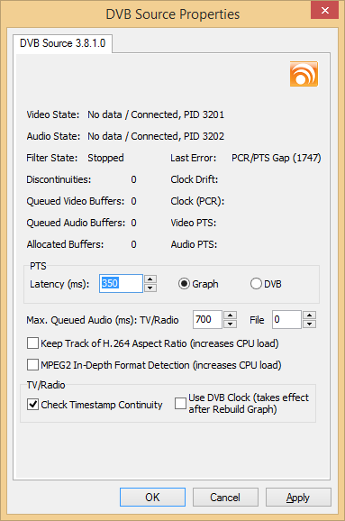

bccrew Posted March 28, 2015 Posted March 28, 2015 Hello, Since a few days I have a strange problem. I have a server with DVBViewer RS running 3 sundtek dvb-c tuners. All my channels are working except 1, Animal Planet HD. Streaming to VLC from the webinterface works, streaming to Ipad2 with the Framework for Rec. Service App works also. Only streaming to different DVBViewer Clients doesn't work. Other channels on the same frequency still work. Data is coming on the PID (I checked with Transedit duh.. otherwise streaming would not work at all.. ) I just see a black screen and the dvbsubs running, no audio or video. I tried changing the codecs but no avail.. No data is arriving in the DVBSource filter..

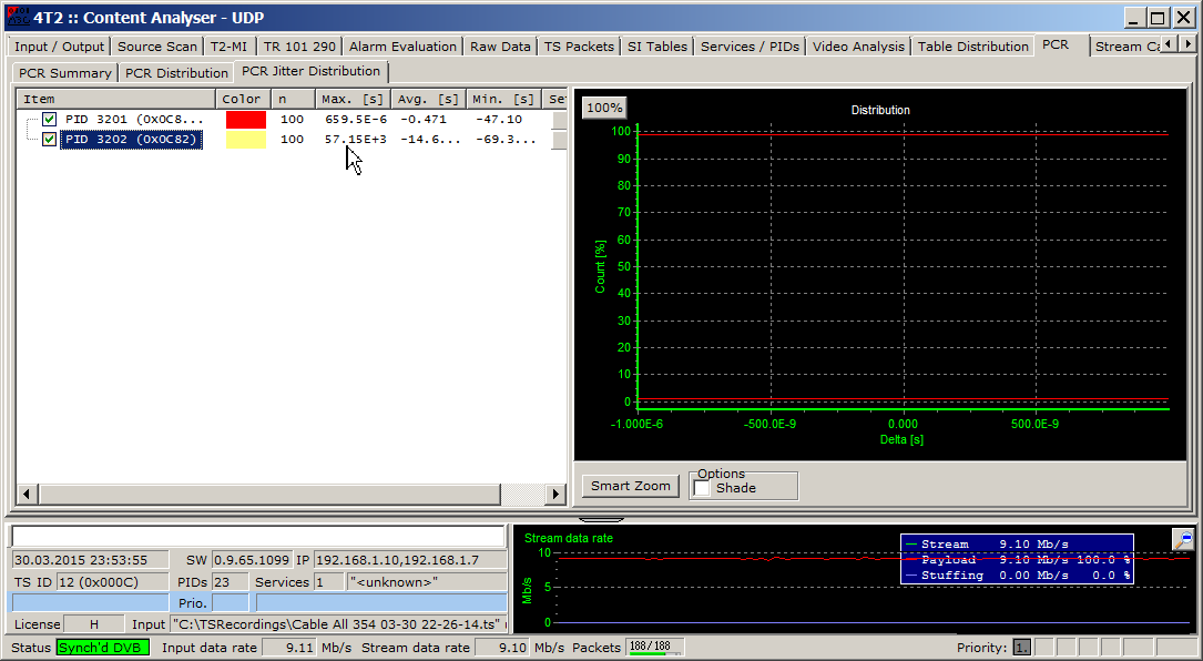

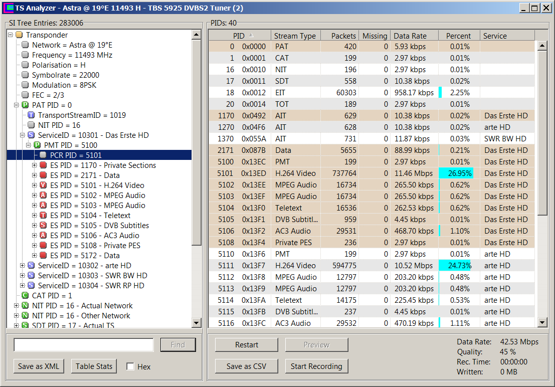

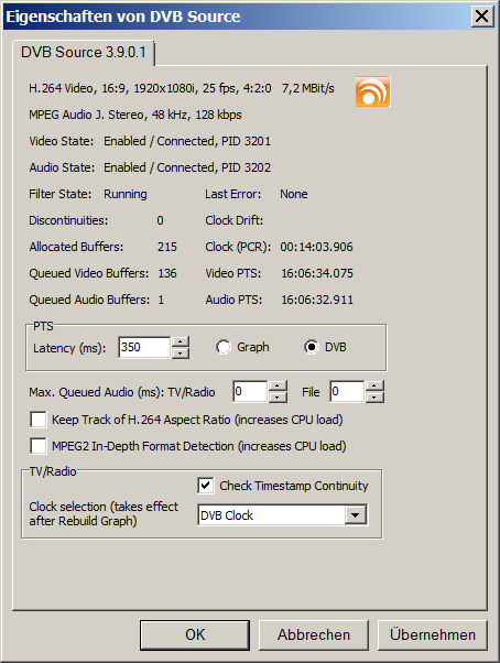

Derrick Posted March 29, 2015 Posted March 29, 2015 ..if it's not a settings problem, it could be the timing. There's something odd in your 1st screen shot. The PCR seems to be missing. Try again with unchecked "Check Timestamps Continuity" (->apply -> ok -> retune). Also please open the transponder with TransEdit's analyser (see my screen shot). Last not least you can record a short sample with the analyser and upload it to a (free) file server.
bccrew Posted March 29, 2015 Author Posted March 29, 2015 Check Timestamps Continuity did the trick :s I wonder how suddenly this setting got changed on all my computers Is it unchecked by default?
Derrick Posted March 29, 2015 Posted March 29, 2015 No, it's checked by default. Maybe the system is too sophisticated and thus less fault tolerant But I've still doubts about you settings. What is the source of your channel list? A PCR is mandatory!

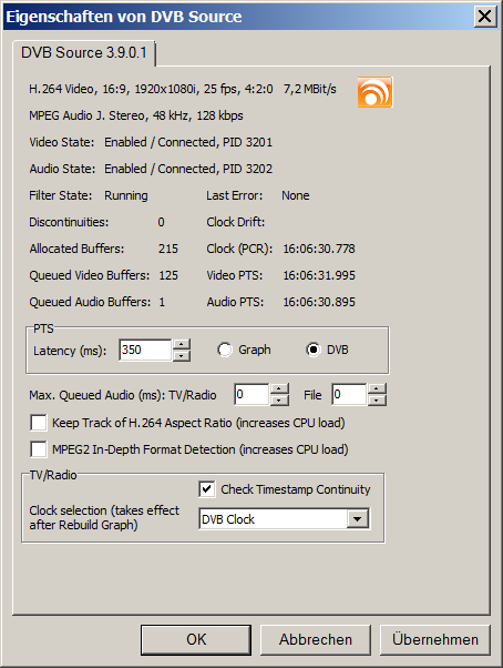

Griga Posted March 30, 2015 Posted March 30, 2015 No, it's checked by default. Maybe the system is too sophisticated and thus less fault tolerant @Derrick: It was you who requested this function some years ago Obviously there is a PCR. A slight misinterpretation of the DVBViewer Filter property page screenshots... @bccrew: "Check Timestamps Continuity" should usually be switched on. However, if a channel permanently broadcasts discontinuous time stamps this error checking mechanism spoils playback completely. Please try DVBViewer Filter 3.9.1,(read the includes ReadMe for more information) which performs a more tolerant error checking. You are using version 3.8.1. I had to rework the code in order to handle the bad time stamp behaviour of internet TV broadcasters. Does it work with DVBViewer Filter 3.9.1 and "Check Timestamps Continuity" ticked?
bccrew Posted March 30, 2015 Author Posted March 30, 2015 Does it work with DVBViewer Filter 3.9.1 and "Check Timestamps Continuity" ticked? To be short, no.. I have to untick the box to get a clear picture on both channels. Can I debug it further with Transedit?

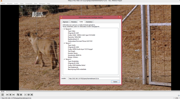

Derrick Posted March 30, 2015 Posted March 30, 2015 BBC One HD from satellite 28E, 10847V? Then the other HD channels like BBC Two HD on this transponder channels should suffer as well. Your screen shot from Animal Planet HD is an encrypted service from the Dutch cable operator Ziggo.

Derrick Posted March 30, 2015 Posted March 30, 2015 Tell your cable operator that the PCR of this channel is very jumpy You'll have to switch the source filter to DVB (my favourite view ). The recording can be played without problem but I have a newer version and live playbck is still something different. Though this won't explain your problem with BBC HD.
Griga Posted March 30, 2015 Posted March 30, 2015 Some broadcasters seem to mistake the PCR for a random number generator...
Derrick Posted March 30, 2015 Posted March 30, 2015 ..or the source filter uses the next adaptation field control = 3 without checking the PID for extracting the PCR I've opened the file with TSDoctor expecting lots of PCR errors, but nothing. Then I searched deeper and found another pcr in the audio stream with pid 3202. That's the jumpy one. 3201 is just fine. Could be a severe bug of the source filter..
Griga Posted March 31, 2015 Posted March 31, 2015 Then I searched deeper and found another pcr in the audio stream with pid 3202. That's the jumpy one. 3201 is just fine. Well analyzed! I can see it in the Transedit Analyzer -> Hex Viewer and reproduce the issue with the TransEdit preview function that does a live simulation. The source filter behaviour is no bug, but intended. Since the PCR PID specified by the host application may be wrong or nonexistant (we already had such cases...), the DVBViewer Filter checks if the arriving streams contain a PCR. If yes, it is used. However, it doesn't consider that there may be two streams containing contradictory PCRs. Looks like I have to rethink the matter...

Derrick Posted March 31, 2015 Posted March 31, 2015 However, it doesn't consider that there may be two streams containing contradictory PCRs. Looks like I have to rethink the matter... Bug or design flaw, the designated PCR should be taken first. And even if there is only a hidden PCR this should be indicated. Otherwise it remains undetected and leads to the wrong conclusion I can record some sample files of channels that don't have this problem if you guys want..? And provide a sample of BBC One HD Only if BBC One HD is from your cable.

Derrick Posted March 31, 2015 Posted March 31, 2015 Sure. But it doesn't help if the video and audio stream of the to-be-played channel contain different PCRs. Then use the PID filters and only take the PCR from a single PID and do not mix different streams. The audio rate of this "HD" channel is appallingly low. Even with first PCR come, first serve, the probability that the 1st PCR is the correct PCR is very high. There is no need to take all you can find without filtering.. ..and btw. when searching for an explanation the source filter can't be trusted any more

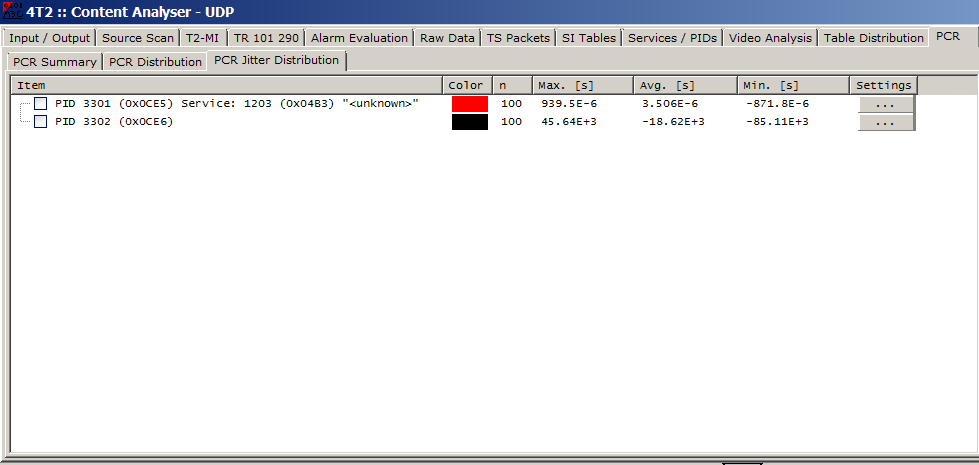

Derrick Posted April 1, 2015 Posted April 1, 2015 ..same story with BBC ONE HD. You'd better take the original from satellite. Shouldn't be a problem in Belgium As shown before due to a design error DVBViewer mixes the faulty hidden pcr with the correct pcr. No problem with EEN HD. Apparently your cable provider is transcoding external HD services. /edit BBC ONE HD is even worse because I can't play this file with any member of the DVBViewer family no matter what dvb source settings I use. Even with TSPlayer (normally the most resilient method ) I have to move the slider first before a picture is shown. All other players (VLC, MPC) will play the file without any problem. Same with streaming to my new Samsung 4kTV
Derrick Posted April 1, 2015 Posted April 1, 2015 The reason why the BBC ONE HD file reacts different could be the fact, that by accident the 1st ts_packet containing an embedded pcr (adaptation field control = 3) comes from the audio stream.

Derrick Posted April 1, 2015 Posted April 1, 2015 Should the PCR always be present in the Video stream? No, there can be a separate pid for the pcr or it can be embedded in some other stream e.g. audio. The application knows where to find it from the PMT. Is the DVB Clock something only applicable for dvb-s? Where can I read up on these specifications? It's the system clock for transport streams (ts). You'll find everything in the ISO 13818-1 PCR_PID – This is a 13-bit field indicating the PID of the Transport Stream packets which shall contain the PCR fields valid for the program specified by program_number. If another stream with a different pid also contains a pcr, the application simply should ignore this. Apparently only DVBViewer looks at other locations as well.
