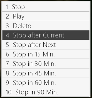

Press the button a second time.
Instant recordings are connected with the playback in the DVBViewer. If you close the DVBViewer you will be asked if you like to stop the recording.
Ok, I see. When I press the button a second time I get the option to stop the recording after x time.

The current programme is already running. So lead time is impossible.
And the follow-up time is used.
I don't see the problem.
