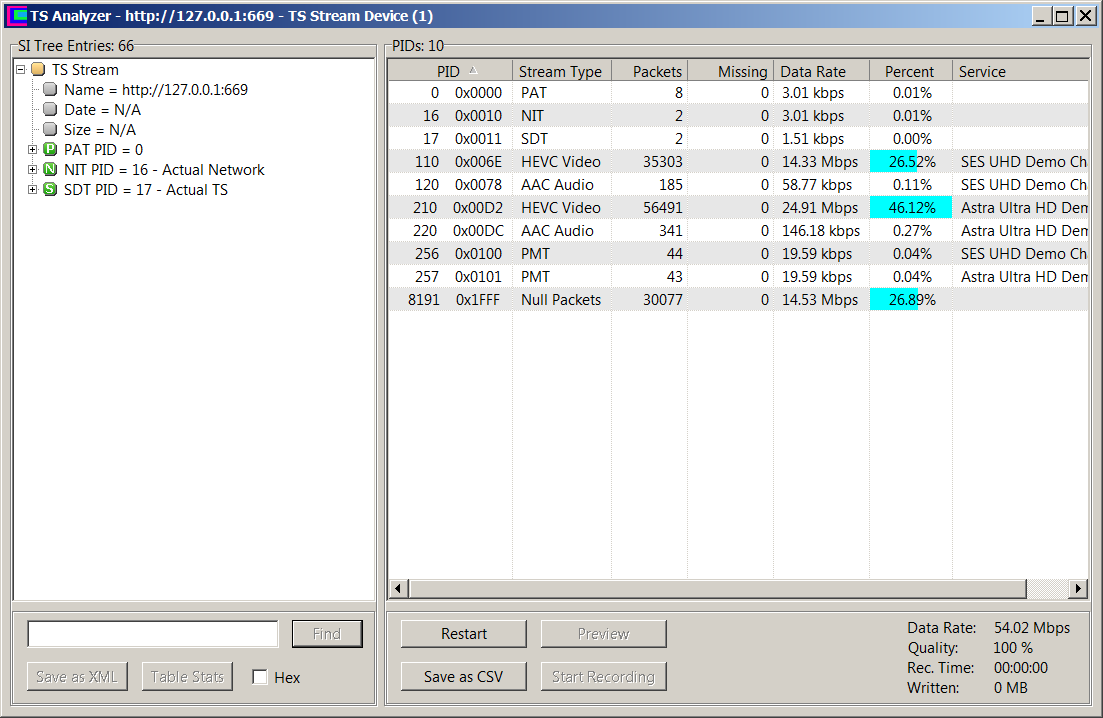

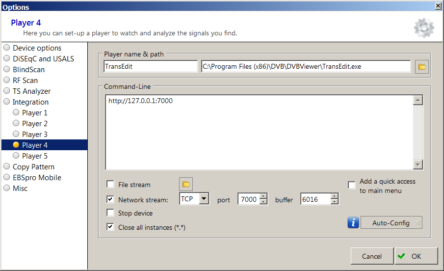

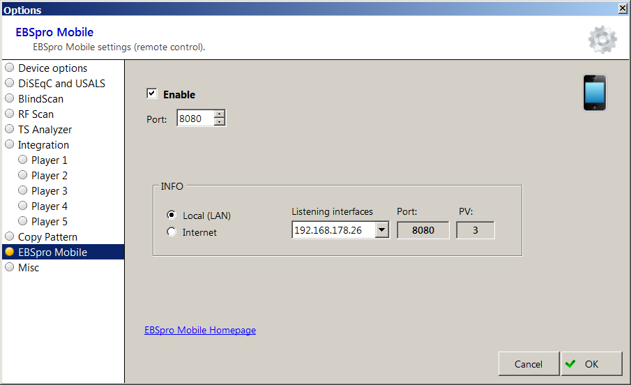

If you have a card that is blindscan capable and supported by crazyscan, you should consider EBSPro. With this tool you can stream to many different analysers including transedit and there is also a server for your smartphone, which is very useful when adjusting a sat dish :)
