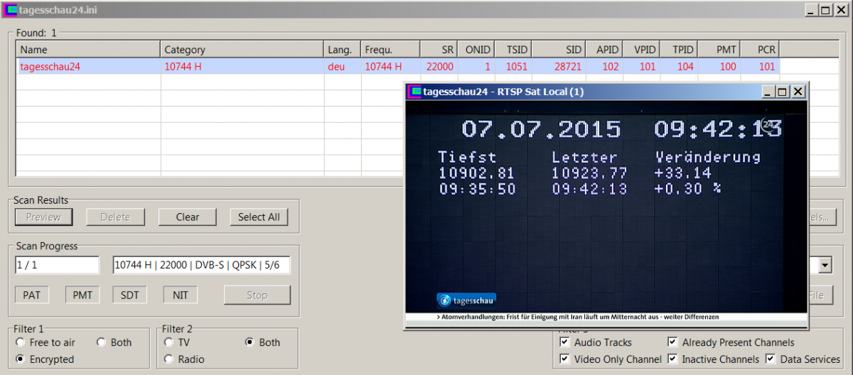

userip Posted July 13, 2015 Author Posted July 13, 2015 Again, there is no artificial limitation. Streams that are scrambled can't be previewed but have to be descrambled by means of a CAM before. Sorry, but this is a completly "artificial" limitation. Please, re-read my previous post #8! Resum: My DVB-C SAT>IP server *can* descramb... but TE don't likes to "preview". If I configure the same DVB-C SAT>IP server on RS, and in TE I change the IP of the SAT>IP server from the one of the physical server to the RS server, then I can "preview"... without ANY other change. THIS IS AN ARTIFICIAL LIMITATION!! Of course the RS is completly transparent (it don't decode anything!) Then, the code includes an "if X then", and it can be safely removed! Please, don't lie to customers! Sorry Derrick, if this sounds high, but I'm sure that Griga undertands perfectly my comment. Quote

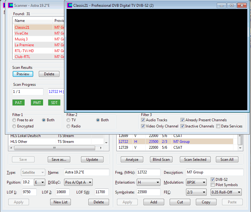

Griga Posted July 13, 2015 Posted July 13, 2015 But this don't work at all! I already tested it (before to post this thread). In TE 4.1.0.0. this entry (HasCI) is unused in the config file (TransEdit.INI). So, it's completly impossible to use it. Here it works: Name.3=Professional DVB Digital TV DVB-S2 ID.3=@device:pnp:\\... TunerType.3=1 HasCI.3=1 Please note that I have applied the tweak to a DVB device, not to a RTSP device. Without HasCI.3=1 I get "Sorry - there is no (free) DVB device available for this action". With HasCI.3=1 the Preview window opens. Of course I get no video, because the DVB card has no CI. But TransEdit believes that it has. Resum: My DVB-C SAT>IP server *can* descramb... but TE don't likes to "preview". Ok, your problem seems to be that the "HasCI" tweak does not work with a Sat>IP server other than the Recording Service. Is this correct? I will check it... What is the name of this Sat>IP server? Quote

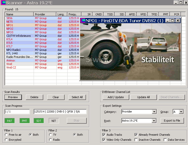

Derrick Posted July 13, 2015 Posted July 13, 2015 Of course I get no video, because the DVB card has no CI. Even if you have a CI the tweak doesn't work properly. At least with a FireDTV/Alphacrypt a scrambled service only can be previewed, if the CAM has been initialized to this service before. Here an example with NPO1 on 19E, 12515H. NPO2 and other channels remain black unless these services have been tuned before by either the DVBViewer directly or a RTSP device assigned to the RS. Quote
Griga Posted July 13, 2015 Posted July 13, 2015 Even if you have a CI the tweak doesn't work properly. It can't because TransEdit doesn't support the FireDTV CI as you should know. In the context of this topic the tweak is only used to persuade the scanner to open the Preview window if the service in question is detected as encrypted, instead of responding with a "There is no (free) DVB device available for this action" message. It isn't supposed to enable CI functionality. It would be easier to handle this topic without your interjections. @userip: You are right. I've checked the code. The HasCI tweak is not supported for RTSP devices. There are two kinds of Sat>IP servers for which HasCi is set automatically on server detection. That are the Recording Service and Digital Devices Octopus Net. For all other Sat>IP servers HasCI is reset. This will be changed in the next TransEdit release. 1 Quote
