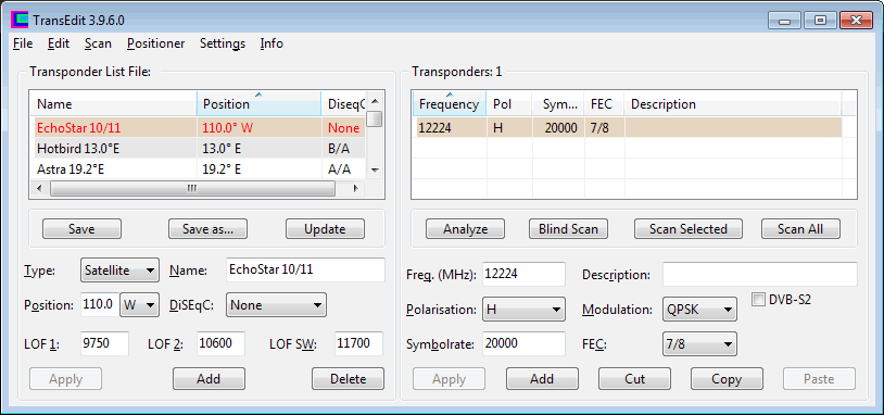

Griga Posted July 27, 2015 Posted July 27, 2015 my satellite dishes are facing, 110.0w, 119w, 129w and 97 w(19/Ku) Far out... from the European point of view. For scanning and finding channels you first need a transponder list for each satellite position that you want to receive. Unfortunately I coudn't find ready-made transponder lists for these satellite positions in the web, so it looks like some manual work will be necessary. This is what TransEdit is made for. First create an empty list: File -> New List -> Satellite. Then enter the orbital position and a name on the left side of the TransEdit main window (110 W, EchoStart 10,11). Click Apply on the left side. Then have a look at this site: http://www.lyngsat.com/packages/Dish-USA-110W.html I found it by searching with Google for LyngSat 110. Now you need to successively enter the data for each transponder. Lets start with the first one (12224 R): Enter the LyngSat data for this transponder on the right side of the TransEdit main window 12224 as Frequency H or V as Polarisation (dunno which one corresponds to R, you need to try) 20000 as Symbolrate (SR) 7/8 as FEC Auto or QPSK as modulation (just a guess - most likely correct) and click Add. It should look like this: Now you can try to scan this transponder by clicking Scan Selected. If it works, repeat the procedure for each frequency resp. transponder listed on LyngSat for 110° W. Then create lists for the other satellite positions... That's basically how to start. However, there are open questions, particularly which mechanism is provided by your outdoor equipment for selecting the satellite orbital position - usually it's DiSEqC. Maybe you can tell a bit more about it... 1 Quote
e123enitan Posted July 27, 2015 Author Posted July 27, 2015 Far out... from the European point of view. For scanning and finding channels you first need a transponder list for each satellite position that you want to receive. Unfortunately I coudn't find ready-made transponder lists for these satellite positions in the web, so it looks like some manual work will be necessary. This is what TransEdit is made for. First create an empty list: File -> New List -> Satellite. Then enter the orbital position and a name on the left side of the TransEdit main window (110 W, EchoStart 10,11). Click Apply on the left side. Then have a look at this site: http://www.lyngsat.com/packages/Dish-USA-110W.html I found it by searching with Google for LyngSat 110. Now you need to successively enter the data for each transponder. Lets start with the first one (12224 R): Enter the LyngSat data for this transponder on the right side of the TransEdit main window 12224 as Frequency H or V as Polarisation (dunno which one corresponds to R, you need to try) 20000 as Symbolrate (SR) 7/8 as FEC Auto or QPSK as modulation (just a guess - most likely correct) and click Add. It should look like this: Zwischenablage01.png Now you can try to scan this transponder by clicking Scan Selected. If it works, repeat the procedure for each frequency resp. transponder listed on LyngSat for 110° W. Then create lists for the other satellite positions... That's basically how to start. However, there are open questions, particularly which mechanism is provided by your outdoor equipment for selecting the satellite orbital position - usually it's DiSEqC. Maybe you can tell a bit more about it... Thanks for your quick response, Awesome, as navigate through the system I saw this page, but I wasn't sure the vaiable to include in each box so left it alone, I shall give this Go when I get home and keep you posted. Cheers! Quote
Griga Posted July 27, 2015 Posted July 27, 2015 P.S. Additionally the Local Oscillator Frequency (LOF) of your LNB is important. If you know it, enter it as LOF1 and LOF2 on the left side of the TransEdit main window and click Apply. If you don't know it you will have to find it out... 1 Quote

Griga Posted July 27, 2015 Posted July 27, 2015 That's a different format. Looks like XML. TransEdit and DVBViewer require transponder lists as *.ini file. Maybe you can post in some US forum like SatelliteGuys and ask for help / information / transponder lists. Maybe there are members who know your kind of equipment and are already receiving the satellite positions with TransEdit / DVBViewer. At least there are some members who are using TransEdit (search with Google for site:www.satelliteguys.us TransEdit). 1 Quote
