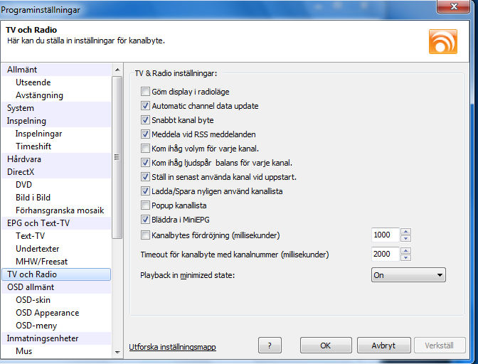

Lpalm Posted August 8, 2015 Author Posted August 8, 2015 Thanks a lot, this has advanced the question a good bit. (pity that so much is missing at least from the English documentation) to adress what you say let me first adress your number 2 there is no TV/radio option in the meny that comes with a right click, but there is one under prrogram settiings ( a submenu to the first one) But in that menu there is no mention of the CAM menu 1) yes i got the CAM menu as an option but it is grayed out and cannot be entered. My DVDViewer installed as per system default in a Swedish version. Can there be problems here maybe I should reinstall and force it to the English version ? Quote

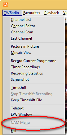

Lpalm Posted August 8, 2015 Author Posted August 8, 2015 A bit of fiddling helps. I ran the setup wizard and set language to English and now the TV/radio entry is at the top of the right click menu!! but the CAM entry in this menu is dimmed and unaccesseble Small steps forward! Quote
Gioxy Posted August 8, 2015 Posted August 8, 2015 Hmmm, so it was a translation gap; ...but you don't need to run setup wizard to change language: as you can see with english set, it's the very first option you can manage from "Settings / Options", and when applyed it change language on the fly... If you are sure you have already installed ciapi.dll, the most probably reason for CAM menu is grayed out seems to be that there is some other software/service using ciapi.dll. To dig on this I suggest to use Sysinternals's Process Explorer: with it you can search what process is using ciapi.dll (use "Find / Find Handle or DLL") and kill it/them; when ciapi.dll can be find anymore, start DVBViever and check if CAM menu turn active. Anyhow, for a better help from other people more expert than me on this subject, better to post a support.zip file following these instructions: How to post problems/bugs correctly: Always follow these instructions. Otherwise no one can - or wants - to help you!. Quote
