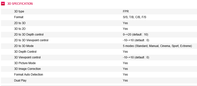

McenterFreak Posted September 2, 2015 Author Posted September 2, 2015 I really don't know very much about 3D, but my TV has these 3D specifications. Would it be possible to Watch 3D from DVBViewer, with this TV? Quote
Tjod Posted September 2, 2015 Posted September 2, 2015 If the 3D channel use e.g. site by site, it should work. But you need to read in the manual for you TV to learn how to activate it in the TV. http://www.lg.com/uk/support/software-manuals > 65UF950V > USER GUIDE Activate "3D Pattern Recognition" or turn 3D on manual. Quote
