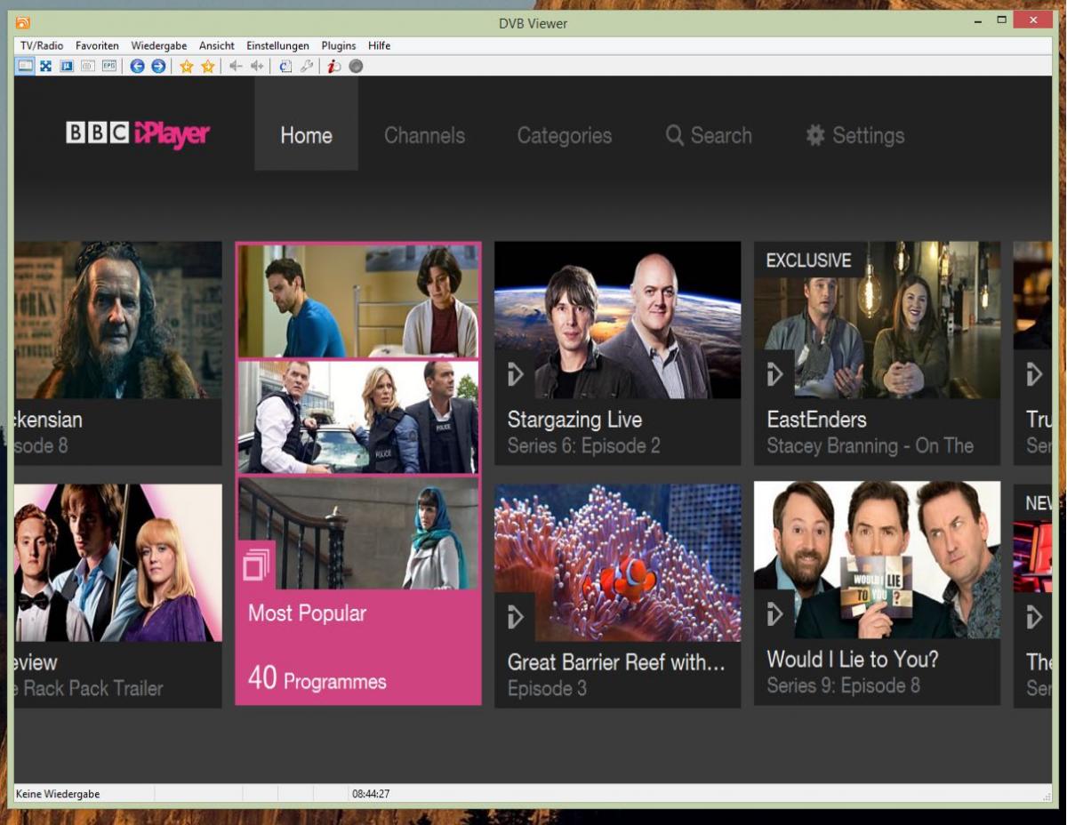

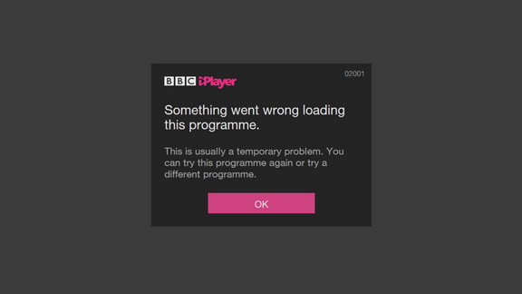

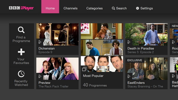

Today by chance I installed new drivers for my TBS TV card and the BBCi player page now loads but plays no streams. I'm assuming its the same problem you have Ive loaded example images.
I was editing the wrong xml thank you for the location of the correct xml after adding your entry still no BBCi player streams play. Unfortunately I know nothing about Java script.

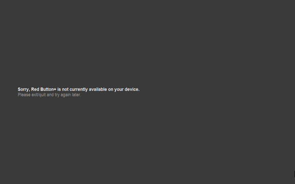

It appears the situation is no different to the first post, if I try to use BBCi player whilst tuned to the BBC I instantly get "sorry red button+ is not supported on your device".
So is it that my hardware is not compatible? or the BBC blocking uncertified equipment?
This is not a hardware related issue. Technically the service only works on certain certified devices and is blocked on the rest.
While you can fix at least the blocking at the start (by using different user agents), getting the video content is more complicated.
I did not debugged the bbc iplayer javascript, but it seem to be that the streams are protected and only played back with an british ip and it seem to be html5 used for rendering.
