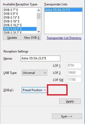

Since version 5.6.0 it is not possible to save disecq type 1.2. preset position 1 to specific satellite. I can set the proper configuration (and see the system working) but after program restart it always lost the settings and move motor to not defined position (probably zero) out of the limit of the actuator. Then when I check the preset position it remembers the type but position number is completely missing.
Confirmed.
However, as far as I can see this is only a visual flaw. After restarting DVBViewer the previously set position number shows up as soon as I select DiSEqC -> Preset Position again.
Did you click Apply after configuring the position number?
Yes, of course I clicked on apply button. I can confirm that when I click on the preset position choice then I can see the proper preset number again. But when I close the application an start it again the actuator starts to move the dish to unknown position until it reaches eastern limit. I have to open channel editor, select satellite's reception settings and confirm the preset position again. After this I can change channels without any issue until new start of the application. Then the dish turns again.
After checking it again I can confirm that you are right: The value is stored correctly in the channel and transponder list, but when DVBViewer (re-)loads the channel list Preset Position is reset to 0.

5.6.2 The problem is still not solved.

I do not have the possibility of shared Preset Position optional Channel editor.
What about the channel scan (reception settings). And a channel scan. The thing what the topic here is about?
You can't change DiseqC settings on channel basis. Only per Sat position in the reception settings.
Click the gear wheel symbol (at the bottom right beside the edit symbol).

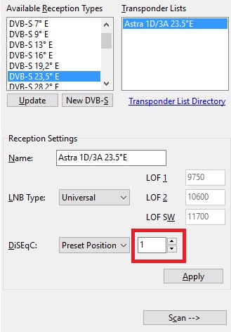

39° E only? That's not a hell of a lot for someone with a motorized dish ;)
Nevertheless, with the shown configuration and after clicking Apply it should work for all channels with 39° E as orbital position. If things are still not working please attach your zipped channels.dat, so I can have a look at it.

Do all that it should be like in the pictures?
In the picture in the post 15 Tuner tupe and DiseqC are not available. Does the way it should be?
Here it looks ok, as it should be.
Yes, that is intended. DVBViewer 5.6.x does not allow to set up DiSEqC per root folder or channel anymore, but only per satellite position. Logical, isn't it?
