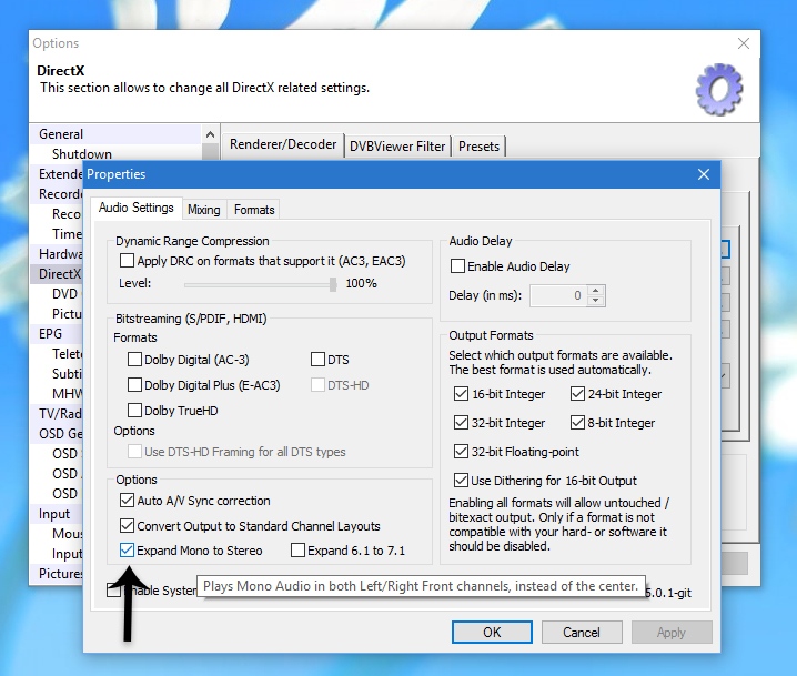

Normally just use Lav filters with DVB but installed AC3 filters and swapped over the audio and the audio is working now
After playing about with setting most of the morning i got the mono channels working with LAV filters
You have to go into LAV audio settings and tick the box Expand Mono To Stereo
Here it works without "Expand Mono to Stereo". Maybe your Audio Renderer resp. Audio Device does not like Mono.
