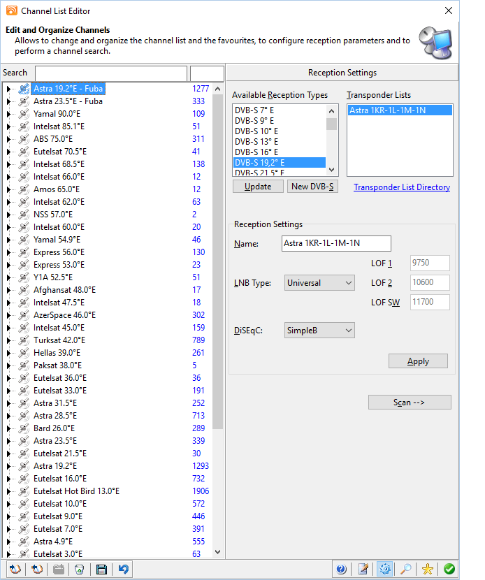

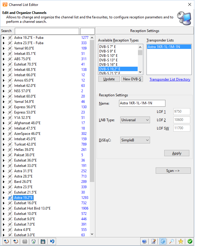

Two DVB-S cards TBS6925 and second TBS6982. The first is connected to Gigertini dish with USALS. The second is connected to the monoblock switched commands Pos. A and Pos. B. for the satellites 19.2E and 23.5E. Channel List of course includes these satellites again for the TBS6925. Each pair of satellites (TBS6925 - (USALS 19.2; 23.5) ) and ( TBS6982 - ( 19.2E Pos. B; Pos. A 23.5E ) ) should make it possible to set up a standalone option DiSEqC. BUT IT CAN NOT. I have the latest version of the DVBViewer Pro. Channel groups are set.

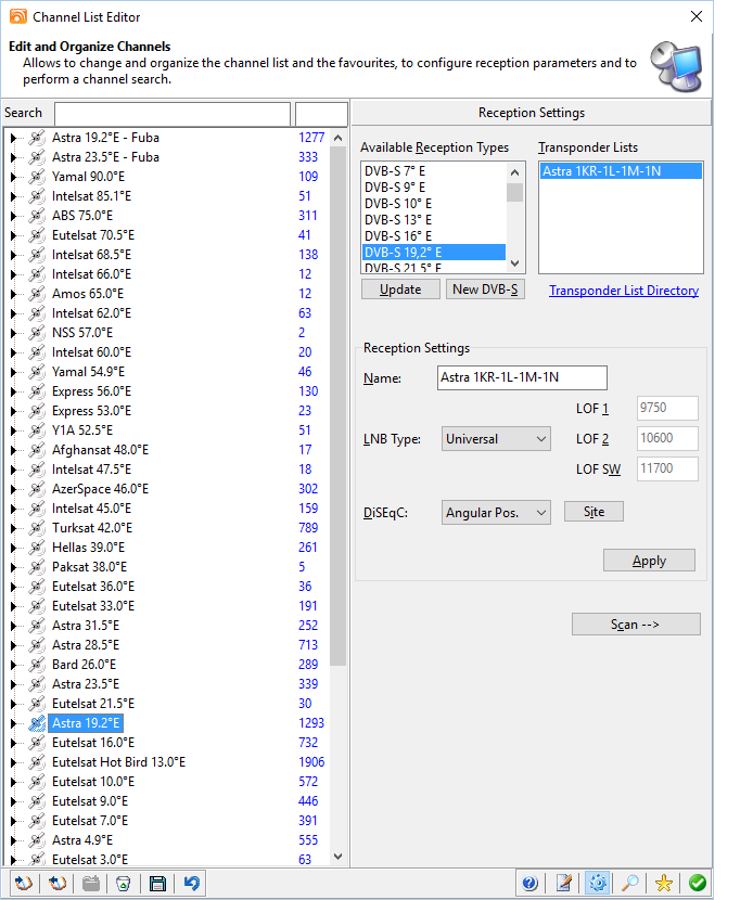

But it is not set. If I change " Astra 19.2 ° E USALS" to USALS, so also changes " Astra 19.2 ° E Pos " to USALS. Just these two entries on the worksheet channels have a common input DiSEqC . Otherwise I can not explain the behavior.

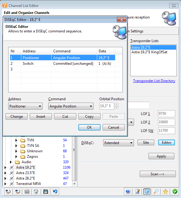

The DVBViewer 5.6.2 UI does not allow to set up different DiSEqC for the same orbital position. There are two solutions, however. Better don't use the orbital position hack proposed above, but try the following:
(1) Set DiSEqC to Extended for the orbital positions in question and open the DiSEqC Editor. Insert the commands for USALS and for the switch in the monoblock LNB:
Since the switch will (hopefully) ignore the USALS command and the motor the switch command, it should work for both. It should even be possible to use a single Astra 19°/23° E channel list for both without channel group assignment.

  • First set DiSEqC = Angular Position for 19°2 E (which means, for all 19.2 channels)
