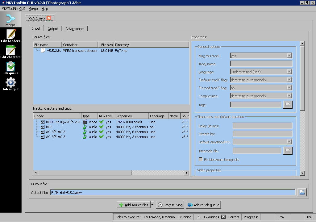

Recording all audio tracks.
mkvtoolnix v 9.2.0 doesn't recognize the AC3 track from .TS file rocorded by DVBViewer v 5.6.2

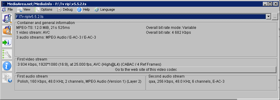

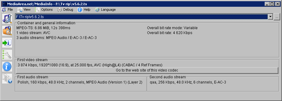

This an error in structure file .TS? MediaInfo correctly detects all audio tracks.

Other media players find all tracks also. MediaInfo show all video and audio tracks.
