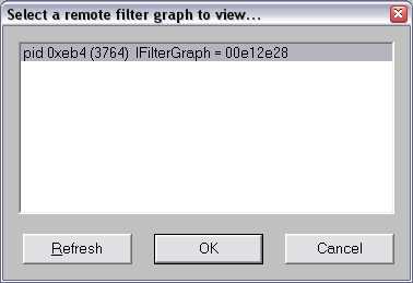

gorope Posted December 24, 2004 Author Posted December 24, 2004 Thanks a lot, griga for your support. I had tryed that you say, but after choose the only remote graph in the list (I'm atached the windows image), nothing appears on graphedit. what is wrong? Thanks again. Quote

Griga Posted December 24, 2004 Posted December 24, 2004 nothing appears on graphedit. what is wrong? Didn't you click OK? Since there may be more than one filter graph running, GrapEdit first shows the list. In your case there is only one entry. The graph is dispayed after double-clicking it or clicking OK. Quote
gorope Posted December 24, 2004 Author Posted December 24, 2004 Sorry Griga, I don't explain it fine. Yes, I press ok button and the windows that I'm post closes but nothing appears on the main window of graphedit. I try it several times. Thanks Davenger for the links, I will try that htpc soft. The informatión about filter graphs is interesting, but a bit dificult for me. I hear never before about this things. Quote
