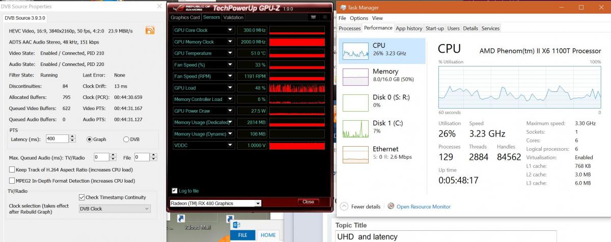

fxv1 Posted July 28, 2016 Posted July 28, 2016 Just a question which I am not sure has an answer. At the monent I am monitoring UHD Demo on Astra 2A (UK) and I get discontinuities. Not many and it does not happen that often, I get many 2 per minute. I have adjusted my dish using a meter and am on 94% signal on that channel. My question is this, does latency settings affect the discontinuities, I have tried with 250, 300, 350, 400 up to 600 and not sure it makes a difference for me. The other question is does SD, HD and UHD need different latency settings ? On the allocated buffers I see 795 allocted and Queued video buffers around the 420 mark. My CPU load is at 20% and GPU load flactuating between 5% and 80% Quote
Clemens123 Posted July 29, 2016 Posted July 29, 2016 (edited) Are you using LAV decoders? Is DXVA2 (Native) activated and running? Which Video Renderer is activated? (if MadVR try Custom Video Renderer) And please upload your support.zip Edited July 29, 2016 by Clemens123 Quote
fxv1 Posted July 29, 2016 Author Posted July 29, 2016 Yes LAV decoder. DXVA native running. Using Custom Video Renderer. I will test with MADvr later on. support.zip Quote
fxv1 Posted July 29, 2016 Author Posted July 29, 2016 (edited) Just tested with MadVR, get a black screen. Had a look at the filter settings, nothing obvious for UHD in there. Using the system default decoder it plays ok but not as good as LAV Edited July 29, 2016 by fxv1 Quote

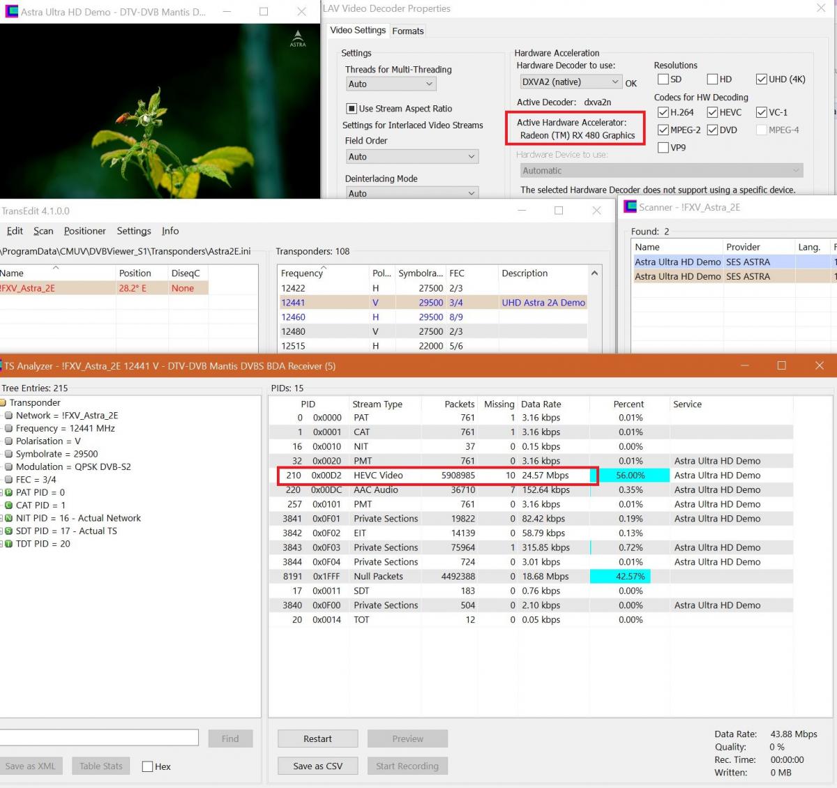

Griga Posted July 29, 2016 Posted July 29, 2016 Discontinuies can be caused by (1) weak or disturbed signal (a good signal strength doesn't necessarily mean a good signal quality!) (2) driver issues (e.g. insufficient buffering that usually can not be influenced, may take effect in case of high CPU load or latencies caused by other drivers, see explanation given here). (3) hardware limitations, limited bus bandwidth (4) discontinuous broadcasts, particularly demo loops where the continuity counter at the end doesn't fit the one at the beginning. Take your choice UHD Demo on Astra 2A (UK) The one on 12441 V? No discontinuities here shown by the TransEdit Analyzer (see download area, recommended tool for checking such things, no playback involved, my PC can't play it anyway...). I'm using a Hauppauge Nova S2 HD connected to a 55 cm dish in the western part of Germany. Quote

fxv1 Posted August 2, 2016 Author Posted August 2, 2016 TransAnalyzer LAV decoder correctly showing the RX480 for HW acceleration, this info is different when in DVBViewer. Few packets dropped HEVC Quote
