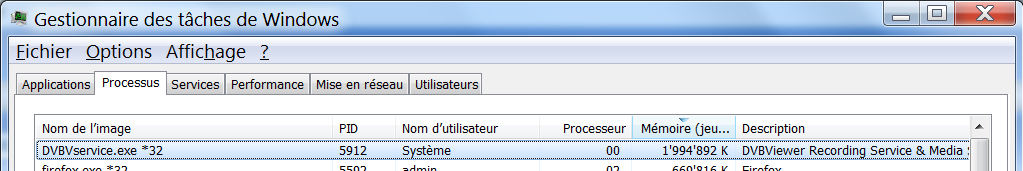

dj_guigui Posted August 22, 2016 Posted August 22, 2016 Hi, After four or five days of use, the Recording Service take about 2 Gb in ram and don't respond anymore ! A stop and Start of the service lead back to a normal state. Sometime a kill of the process is required to start the service again ! I use WebGrab+Plus to get EPG from Horizon Website and XEPG to import it into Recoding Services ! This work fine but perhaps is the source of the problem ? Can you help me ? Thanks in advance Thierry

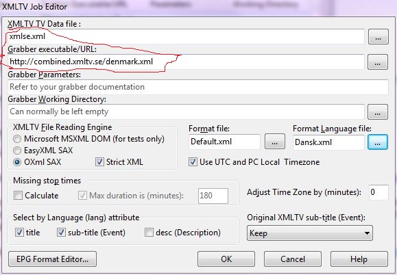

Delphi Posted August 25, 2016 Posted August 25, 2016 @Griga: If you want to try Xepg, I suggest to use an internet file download as a first try. This is to avoid any other processes like WebGrabPlus (could that be the problem?) to be involved. Click Add button in Xepg: You can use this file (just do some fake pairings) or find another one that fits better to your channels. You will have to read in the help files (buttons) to learn more about Xepg, sorry. I shall ofcourse be happy to answer any questions you might have. @dj_guigui: How do you automate the process? Please upload your Config.ini file. Remember to delete any personal information (passwords etc.) before upload.

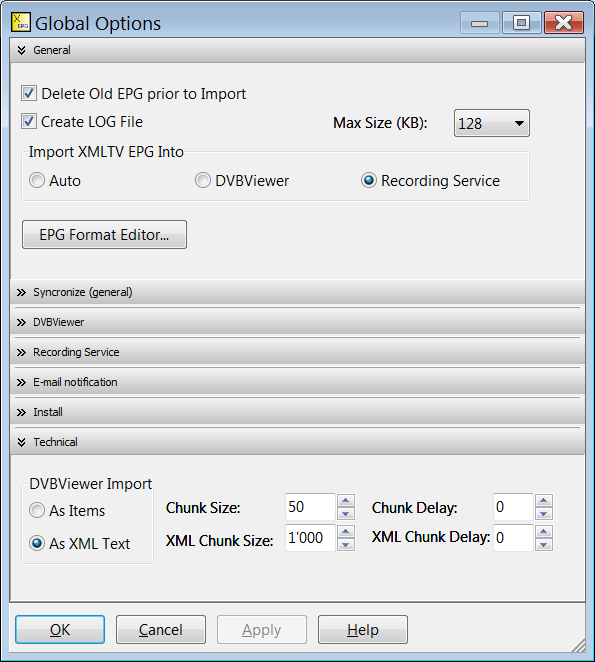

Delphi Posted August 25, 2016 Posted August 25, 2016 @dj_guigui: A very simple thing to try is to check Xepg > Options > General > Delete Old Epg prior to import Just to make sure the epg does not add up in RS ------------ You have [Job0] Grabber=Grab_KevinPato.cmd Please upload this one including any extra files needed to run it. I have never seen this before, please explain.

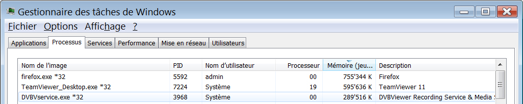

dj_guigui Posted August 30, 2016 Author Posted August 30, 2016 Hi, Sorry for delay, i was out for the week-end. To answer the question, i do not put the pc to sleep after the import After some testing, i can tell that : Option "Delete Old Epg prior to import" in XEPG don't change anything. When i came back from week-end, RS was stuck again at about 2 Gb (see "Recording Services2.jpg" attached file). And XEPG can't import EPG anymore (see "Xepg.LOG" attached file). After a restart of the RS and modifying the launch of XEPG to use a process task timer in RS, i can see this morning that RS has grow up in ram to about 300 Mb (see "Recording Services3.jpg" attached file) but the Xepg log tell that everything is allright (see "Xepg2.LOG" attached file). Now i try to activate this option "ReportMemoryLeaksOnShutdown=1" on Xepg config.ini to see if something is reported. The next step will perhaps be to give you my xml files to check if they are in a valid format ? At last, in Xepg, can the option to import as Item or Xml Text change something ? Thanks again for your help. Xepg.LOG XEPG2.log
Delphi Posted August 30, 2016 Posted August 30, 2016 I don't see anything wrong in the LOG files. Now i try to activate this option "ReportMemoryLeaksOnShutdown=1" on Xepg config.ini to see if something is reported. Then go back to using Windows Task Scheduler to avoid a pc stall. Well, even if Xepg produces a memory leak then AFAIK windows should clean up that leak since Xepg exits after import. Anyway, it's worth a try. I am not an expert on windows memory management. At last, in Xepg, can the option to import as Item or Xml Text change something ?No, this is for backward compatibility only and for importing directly into DVBViewer. The next step will perhaps be to give you my xml files to check if they are in a valid format ?You can test this by temporarely using "XMLTV File Reading Engine" > Microsoft MSXML DOM (see Help). Two more things to try: 1) Xepg > Options > Syncronize (general) > Syncronize EPG reception of DVBViewer channels with Xepg pairings (see Help) This is to avoid imported EPG to be mixed up with antenna EPG (could this be the one?). 2) To have as few players in action as possible use the same XMLTV File Reading Engine for all grabbers. I suggest OXml SAX. -------- In case the additional testings produces nothing, the files I need are: The xml files Pairings.xml Config.Ini channels.dat
