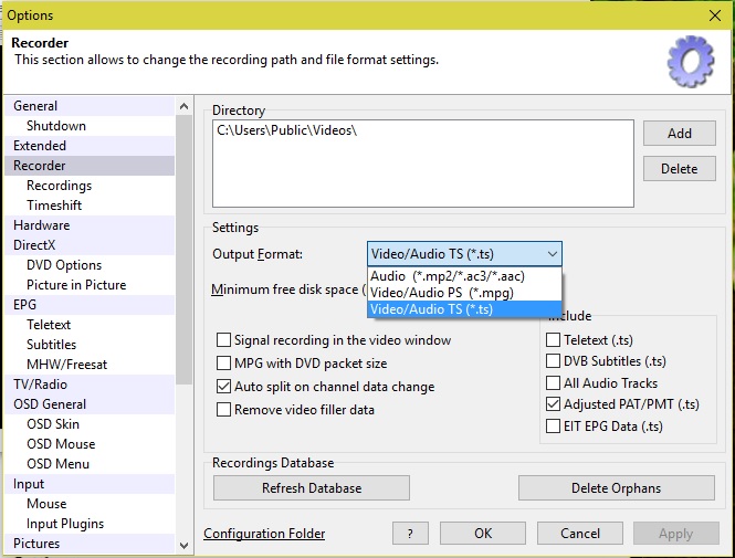

fiorellop Posted April 8, 2017 Posted April 8, 2017 How do I use the h264 codec for recording DVBViewer Since there TV programs from the current profile (Video / AudioTS .TS) generates very large files! Thank you Quote

Griga Posted April 8, 2017 Posted April 8, 2017 DVBViewer records as broadcasted. No Codecs involved. Can't be changed. Recordings are independent from playback and everything associated with it. Codecs, renderer, volume changes, picture settings etc. are all out of the game. With other words, you are at the broadcaster's mercy as far as it concerns codec and bitrate. Quote

Griga Posted April 8, 2017 Posted April 8, 2017 Looks like you do not understand my answer. If you want to make recordings smaller you need to use some tool for reworking them after they have been recorded. DVBViewer won't do it for you. Quote

fiorellop Posted April 10, 2017 Author Posted April 10, 2017 (edited) As these profiles exist for registration: Settings -> Output Format -> Audio (.mp2 / .AC3 / .aac) Settings -> Output Format -> Video / Audio PS (.mpg) Settings -> Output Format -> Video / Audio TS (.TS) How occur this profile registration list: Settings -> Output Format -> Video / Audio H.264 (.mpeg-4) Edited April 10, 2017 by fiorellop Quote
Tjod Posted April 10, 2017 Posted April 10, 2017 There is no .mp4 container support in the DVBViewer. .ts is the format used by the TV stations. So there are no big changes necessary. And one audio strem doesn't need much work. So .mpeg (MPEG2) is the exception. It was integrated quite a while ago. I don't expect support for other formats in the foreseeable future. Quote
Griga Posted April 10, 2017 Posted April 10, 2017 1 hour ago, fiorellop said: As these profiles exist for registration: That are no profiles, but container formats for video/audio. Profiles are a different thing. DVBViewer does not support selecting profiles for recording. Quote
