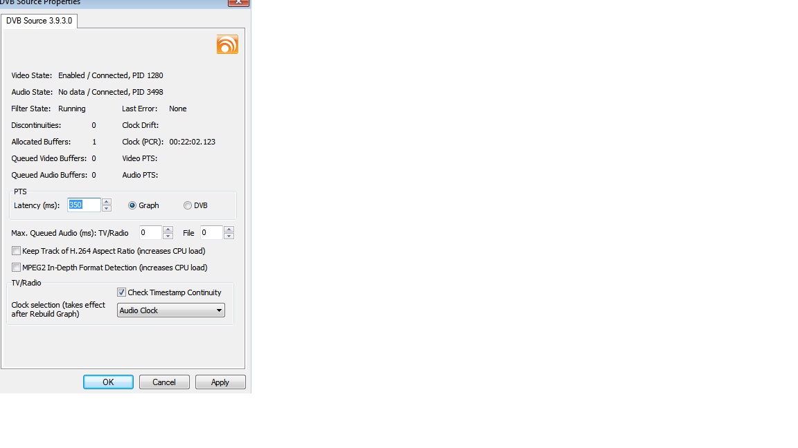

When I tune to encrypted channels : dvb source Video state is enabled, but audio not enabled.

I have attached a screen shot of dvb sourse
