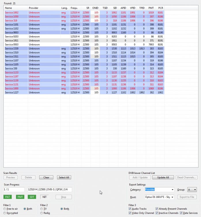

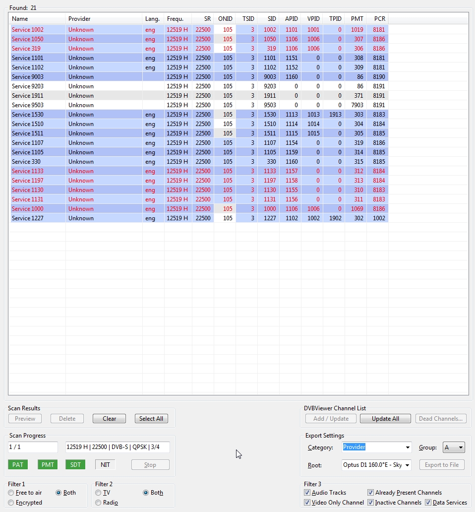

I have just upgraded to DVBViewer Pro 6.0.0.1.  I am using it with a minisatip SAT>IP server and a TBS-6909 DVB-S2 card to view channels from my Sky TV New Zealand satellite service.  Minisatip is decrypting the channels using [ removed, violating forum rule §13] and my Sky card.  Since the upgrade, every time I scan the Sky TV transponders, the 12519 MHz transponder channels do not have their channels names shown, just names like "Service 1002".  The names were appearing when scanning using the older version I had installed previously (5.6.3).  And when I do a scan using a script on my Ubuntu box where minisatip runs (using dvbtune and scan-s2), the names for the channels are shown:

TransEdit also has the same problem - see the screen capture attached.

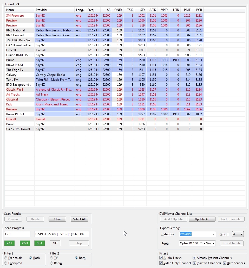

I just installed a copy of the TransEdit 4.1.2 .exe file into my DVBViewer direcory and ran that.  It does find the channel names.

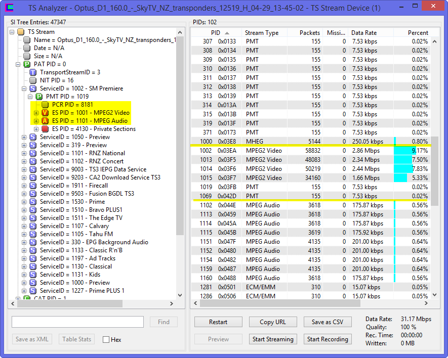

Analyze is seeing the SDT just fine, but Scan is just not using the information.  The forum is not allowing me to attach the screen capture that shows this, so I have put it on my web server, along with a recording of the entire transponder for 30 seconds (120,569,288 bytes).  Using Scan and Analyze on the recorded data shows the problem.

There seems to be nothing wrong with the behavior of Transedit. All SI tables are read correctly. Take a look at the PAT and PMTs. All names from the SDT are assigned correctly.
But for several services the relating elementary streams are missing. There are no corresponds PIDs in the multiplex (e.g. SM Premiere).

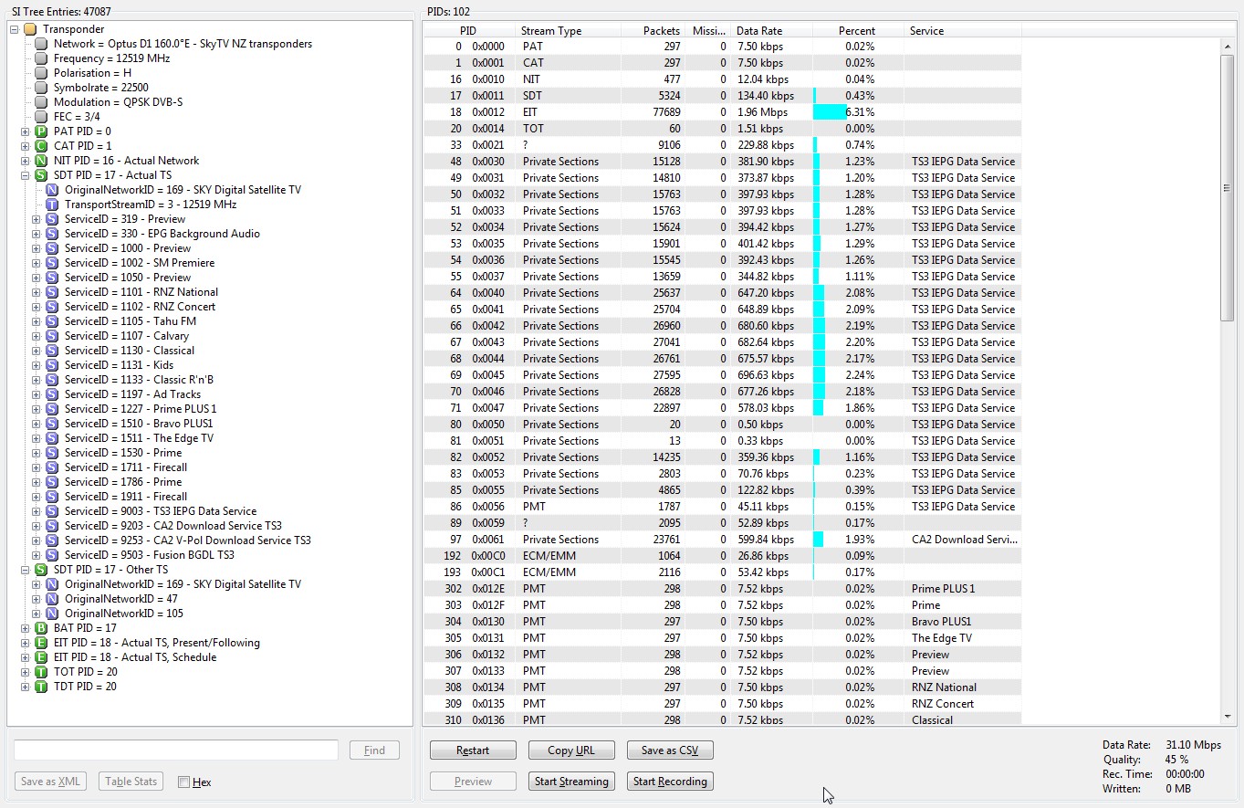

@Derrick: Have a look at the last entry in the SDT for other transport streams. Then you will know what happens... I'll explain it later.
Jep, there's the bug. Another but empty TransportStreamID = 3 - 12519 MHz but with a different OriginalNetworkID = 105
Before I didn't perform a scan of the ts file. I've just looked at the analyzer ;)
It's caused by the algorithm that considers that the data may be located in the SDT for other transport streams (though according to the DVB specs it should be located in the SDT for the actual transport stream).
If TransEdit detects a section with a matching transport stream ID (3 = TS ID in the PAT) in the SDT for other transport streams, it sticks to it instead of ignoring it because it is empty. However, due to timing conditions it may also detect the corresponding section in the SDT for the actual TS first, yielding correct results
That's the problem with methods that are supposed to work around known faults of broadcasters... the may cause additional pitfalls.
Irrelevant. After reading the PAT there is no Network ID that can be compared with the one from the SDT. The SDT is the only Network ID source for the scanner. So if the scanner finds a suitable SDT section (with the transport stream ID that equals the one from the PAT) there is no choice.
Anyway, the next TransEdit and DVBViewer bugfix releases.will ignore empty SDT sections and solve this particular problem.

I have now set up my test PC with my old DVB-S2 cards and finished adding support for my LNB to the Linux dvbv5-scan program, so I could test using that.  It also shows the same problem of not finding the channel names on the 12519 transponder.
