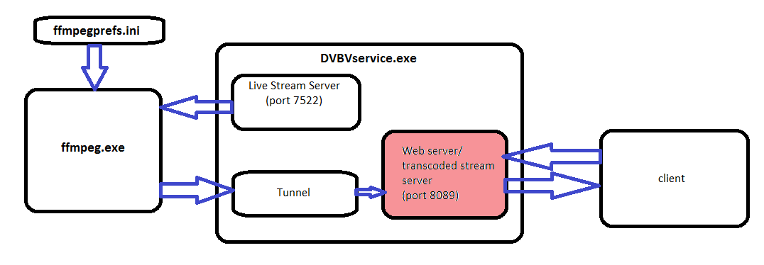

thaischumi Posted May 11, 2017 Author Posted May 11, 2017 I tried to modify ffmpegprefs.ini as much as possible but it didn't help. Arcoding to this diagram I think problem is in the Web/transcoded streaming server:
Griga Posted May 11, 2017 Posted May 11, 2017 9 hours ago, thaischumi said: But with transcoded streaming I am not able to watch if i have streaming bitrate over 3Mbps. What happens? No picture / audio at all? Playback disturbed in some way? Did you modify the FFmpeg presets? The maximum buffer capacity between FFmpeg input to the server -> server output to the client is approx. 1.4 MB. This means 2.3 s with a 5 MBit/s stream. Maybe too little in your case?
