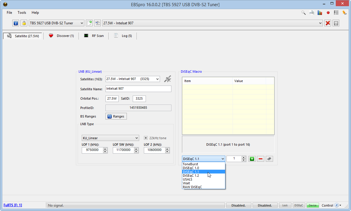

Below I took for example some transponders from Eutelasat 16 ° E.  As they look at EBS photo  they have a good signal.
These transponders I also scanned with TransEdit (with select all opsion) but as they look in TransEdit's picture no channel was found
There are no DiSEqC settings for 16E in Transedit! You have to configure 16E accordingly as you apparently already have don for the other positions.
DiSEqC  settings from EBSPro are not exported!

Is it working ok for the other positions like 7E? The screen shot showing 7E only shows 1 line. It's not a complete diseqc 1.1 command string.
If it's working with EBSPro why don't just copy the commands to Transedit?
