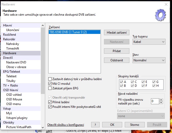

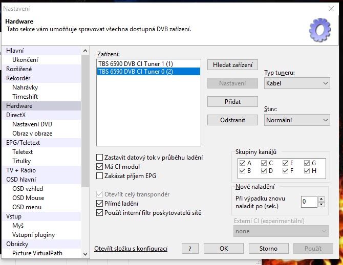

Patt1 Posted August 23, 2017 Author Posted August 23, 2017 Halelujaaaah...I do not know what happened, but today I'm finally starting to work. The only change that was made was that the DVBViewer has 2 tuners in the hardware configuration - TBS 6590 DVB CI TUNER 1 (1) and TBS 6590 DVB CI TUNER 0 (2) - pic. 1. While scanning the frequency, the program offered only the TBS 6590 DVB CI TUNER 1 (1) tuner, but it did not find anything. I therefore manually "removed" the TBS 6590 DVB CI TUNER 1 (1) tuner, and the abbot started scanning with a second tuner and received all the channels. Is it possible that the program somehow will not be able to detect both tuners at the same time and each of them should run separately? Or why is the TBS 6590 DVB CI TUNER 1 (1) nothing tuned? Quote

Griga Posted August 23, 2017 Posted August 23, 2017 1 hour ago, Patt1 said: Is it possible that the program somehow will not be able to detect both tuners at the same time and each of them should run separately? Both should work at the same time. 1 hour ago, Patt1 said: Or why is the TBS 6590 DVB CI TUNER 1 (1) nothing tuned? Possible reasons: Not connected to an antenna cable or damaged. 23 minutes ago, Patt1 said: what is the difference between CI and CI + module? CI modules work with TV cards, CI+ don't (at least not with legal measures). It is not supposed to work because a PC environment does not allow a safe content protection. Quote

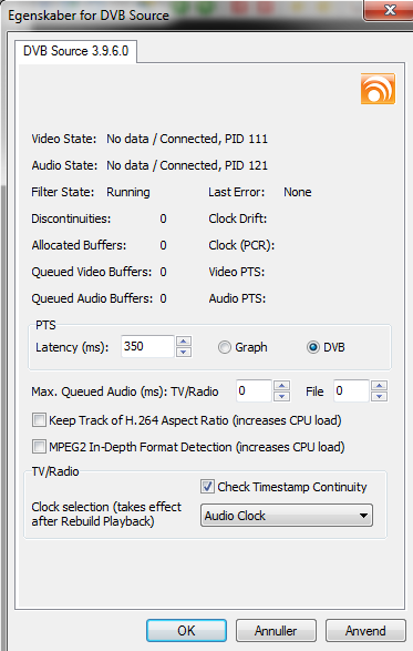

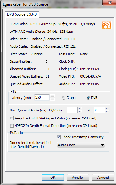

Griga Posted April 13, 2020 Posted April 13, 2020 27 minutes ago, Keld Damsbo said: DVB-T encrypted channels work. DVB-T clear channels does not work (is 2 seperate MUX) That's strange because unencrypted channels are far easier to process than encrypted channels. I can see no reason for it. What does the DVB Source property page show in PTS -> DVB display mode? 29 minutes ago, Keld Damsbo said: I can not search channels, then DVBViewer freezes I've tried two times to scan the DVB-T Europe list with my TBS 5580 multistandard USB box, but to my surprise it did not crash (in the past I've experienced several stability problems with TBS drivers, particularly on fast frequency changes). All scan results were DVB-T2, though not flagged as such in the DVBViewer Channel Editor, because the DVB-T Europe transponders as origin are not flagged as DVB-T2 (that's a result of the latest changes). Unencrypted channels could be viewed, enrypted channels could be received, but not viewed, because I can't decrypt them. ATM I have no more idea what could be enhanced... in my experience one can spend a lot of time with TBS devices without getting to a satifying state Quote

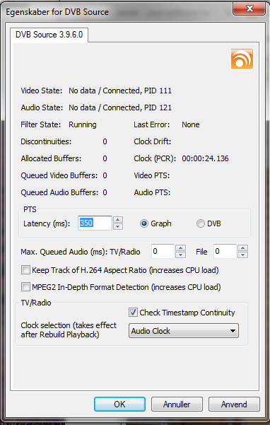

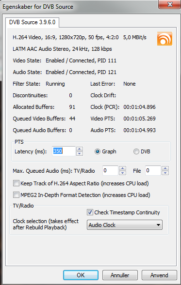

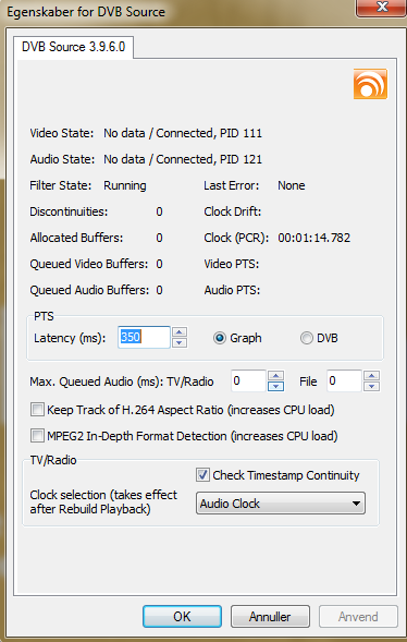

Keld Damsbo Posted April 13, 2020 Posted April 13, 2020 1'st picture is with TBS-6590 card for DVB-T unencrypted channel 2'nd picture is with Hauppauge HVR-2200 card (Only DVB-T card, no DBV-T2) for DVB-T unencrypted channel Quote
Griga Posted April 13, 2020 Posted April 13, 2020 On 4/12/2020 at 1:09 PM, Griga said: You can also check on the DVB Source property page after clicking the DVB radio button (!) if reference clock (PCR) data is coming in. It's always unencrypted. 2 hours ago, Griga said: What does the DVB Source property page show in PTS -> DVB display mode? Unfortunately you didn't follow my advice. The Graph PCR is always present, because it is generated in your PC. However, the interesting part in your case is the incoming DVB PCR. Quote
Griga Posted April 13, 2020 Posted April 13, 2020 That means, the TBS device can't receive this channel at all. What does the signal strength/quality percent value in the status bar indicate? Is the DVB-T2 checkbox for this channel in the Channel Editor unchecked? I can't see a reasonable explanation for this issue, since a channel search with the TBS device found this channel and encrypted channels from another DVB-T transponder work. Quote
Keld Damsbo Posted April 13, 2020 Posted April 13, 2020 Yes its strange. The channel was found with Vendor=33. Now I cant search channels with your beta, then DVBViewer freeze. Signal is the same as the other channels, and so is quality (green) 48% DVB-T2 is unchecked The channel works okay with Hauppauge HVR-2200 Quote
