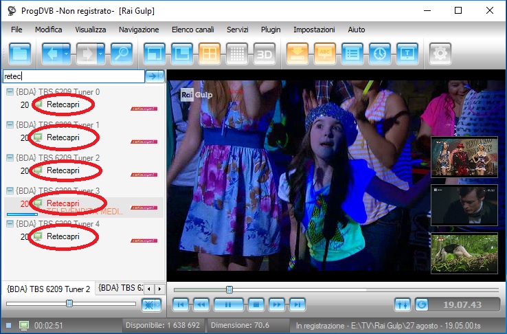

hi, before to buy the program, i have to ask this:
i have a professional digital terrestrial tuner: tbs 6209 (octa-tuner).
with DVBViewer for use all 8 tuners, or at least 3 tuners,
i must open 3 or 8 time the program like dvb dream or
i can open all receivers in 1 time like progdvb ???
thank very much.

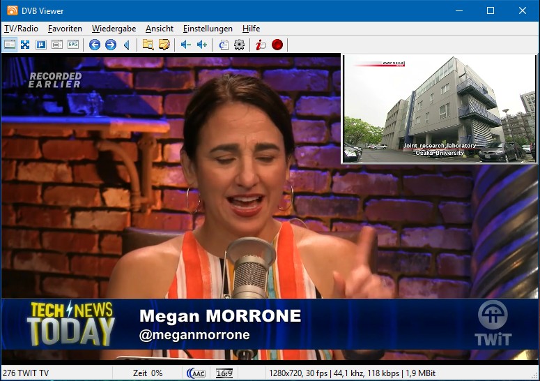

Thanks for your explanation. I want two channels at the same time. Any suggestions please!
Two channels are possible in the DVBViewer via PiP:
So what is the problem by your tester in the DEMO?
Or your question?
